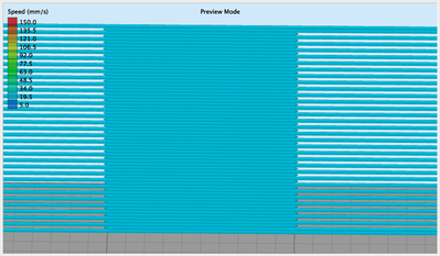

Here's a picture to illustrate the bug where the first and last tool change scripts are done with 2 changes per layer, not 1 as the others are. I zoomed in to show just the purge walls created by my G-code. I specifically made the walls overlap some so that you can see this problem easily.
On the right is a line that is printed with process 1. The left is process 2. Here's the tool change G-code I used to show this buggy result in Simplify3D:
Process 1 Tool Change G-code Script:
Code: Select all
G1 X-10 Y-70 F1200 ; Move to the start position of a new line
G1 X-50 Y-70 E2 F1200 ; The value of E is changed by Simplify3D, but need to be there to print a line
Process 2 Tool Change G-code Script:
Code: Select all
G1 X-20 Y-70 F1200 ; Move to the start position of a new line
G1 X50 Y-70 E2 F1200 ; The value of E is changed by Simplify3D, but need to be there to print a line
In the Simplify3D 2.2.2 screen shot above you can clearly see that 2 tool change scripts are run at the first and last layers, causing 2 lines to print a portion in the same exact location. All of the other tool changes happen only 1 time per layer. It's all goofy. We should get 2 tool changes per layer, not 2, then 1, then 2.
The problem is that process 1 changes behavior. Process 2 has consistent behavior. But in my opinion both are not correct. We can see that the lines made by process 2 on the left print every other layer. Process 1 is printing lines every layer for the first 2 layers, and then every other layer, and then again every layer for the last 2 layers. Both process 1 and process 2 should be consistent, but they aren't. And both processes should print this G-code EVERY LAYER, not every other layer. It's all messed up.
