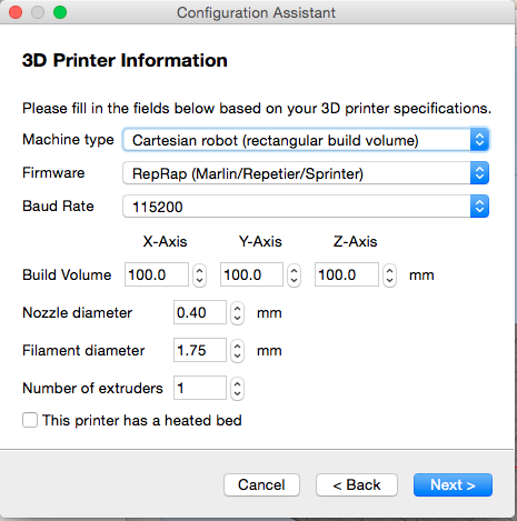

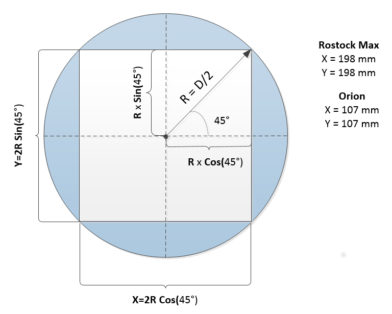

Machine Type: This is pretty standard, if you have a delta printer or circular build plate it will be a delta style build platform. For delta users, you will take your diameter, multiply it by .707 and that will be the X-axis and Y-axis size to input for Build Volume.
Firmware: RepRap(Marlin/Repetier/Sprinter) most printer choices will be for this. Especially since almost every MakerBot/Sailfish style printer I can think of has a build in profile already on the Configuration Assistant you can pick from.
Baud Rate: This is the rate at which USB transmission occurs, your manufacturer can provide this information if you don't have it. **Generally 115200 or 250000** will be the baud rates.
The Build Volume, Nozzle Diameter, filament diameter, number of extruders and check mark for a heated bed are all pretty self explanatory.

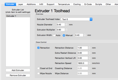

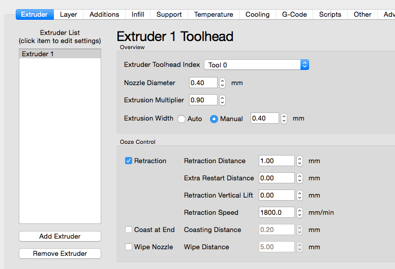

2.Retraction (Extruder Tab)
For standard Direct Drive, usually .5 to 2.5 mm will work well. For Bowden style extruders, 5 to 8.5 mm seems to work well. Changing the retraction speed may also help quality, the default 1800 mm/min is usually pretty good though.
3.Extrusion Multiplier (Extruder Tab)
The default extrusion multiplier is .9 for PLA and 1.0 for ABS. If you notice that there's incomplete filling or if there's too much filament I highly advise tinkering with the extrusion multiplier. My general tinkering, I usually adjust the value by .03 at a time for test prints.
