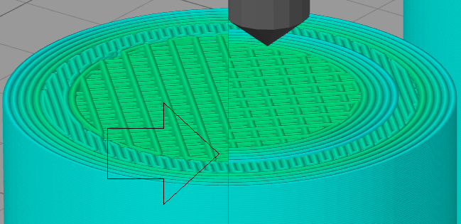

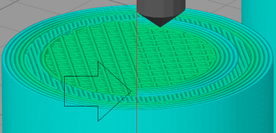

I'm running version 2.2.2 on windows 7 x64, and am printing on a makergear M2.

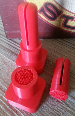

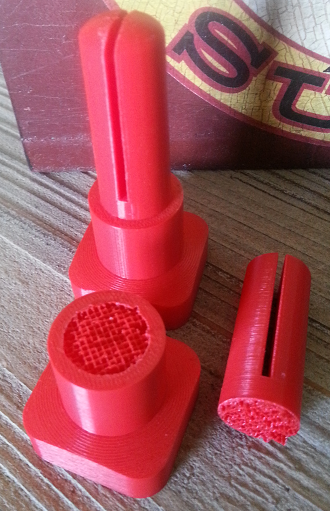

I have this small toy nail that I'd like to print with more layer thickness to make it less likely to break, but there is no foundation being placed between the the upper and lower cylinder.
The walls of the upper cylinder are being placed directly on the infill, which results in a failure point.
I've pasted 2 screenshots of the gcode preview side by side with an arrow pointing at the clear flaw. You can see the 5 perimeters of the upper cylinder are being printed directly on the infill from below, with no foundation under them, so the adhesion is poor at best and the toy breaks easily at this location.

Broken prints:
nail prints
nail prints

The best way to make a strong bond there would be to make several solid layers at that intersection between the small and big cylinder. That way you will get a really strong bond. I would also use another process for the top section. This way you will have the top and bottom solid layers printing on top of each other which produces a very strong bond. When you go to print, just make sure to select both processes and use a continuous printing mode.

While its true you can run another process to get a stronger bond...but you shouldn't have to run another process to get the slicer to work properly. So running another process is actually requires running 3 processes, the first, the solid and another to turn back to your original process setting. I don't mean to come off as an ass...but the slicer doesn't work properly in these situations.

My work around is making a super thin cut inside the part, usually .0005" thick in that area to force it to create thicker walls, it'll create your border passes around the cut and beacuse its so thin it'll bond together.

yeah you can do that or add a process with 100% infill from just below the area in question to just above...then do a third process that goes back to your desired infill
