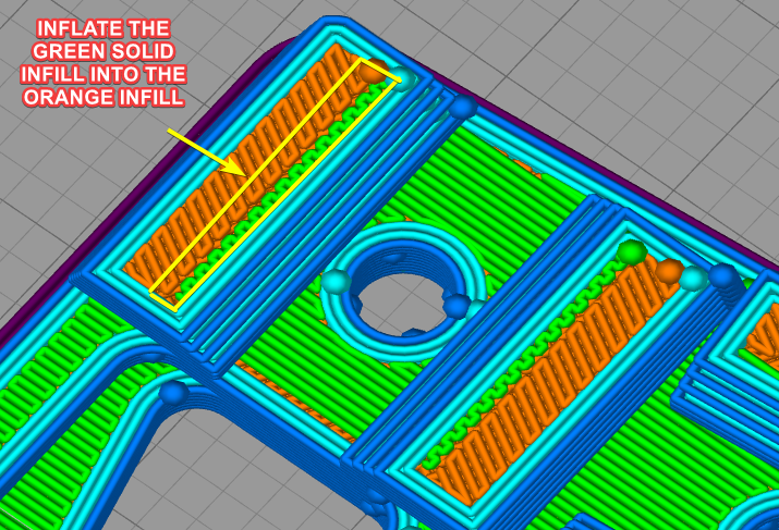

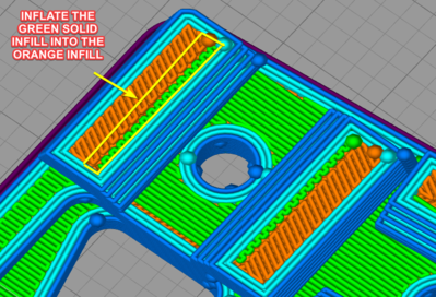

Extra Inflation Solid Infill Distance into Infill setting. Stronger bond, stronger part.
In the past few update the Solid Infill surface infill has gotten better. But still keep running into problems where S3D just puts tiny bits here and there when near inclined surfaces are involved. Making these solid areas bigger if they exist would not be a problem. This would comparable to the Inflate distance of bridging parameter. This would push the solid infill more into the sparse infill creating a better bond with the space and vertical walls.
