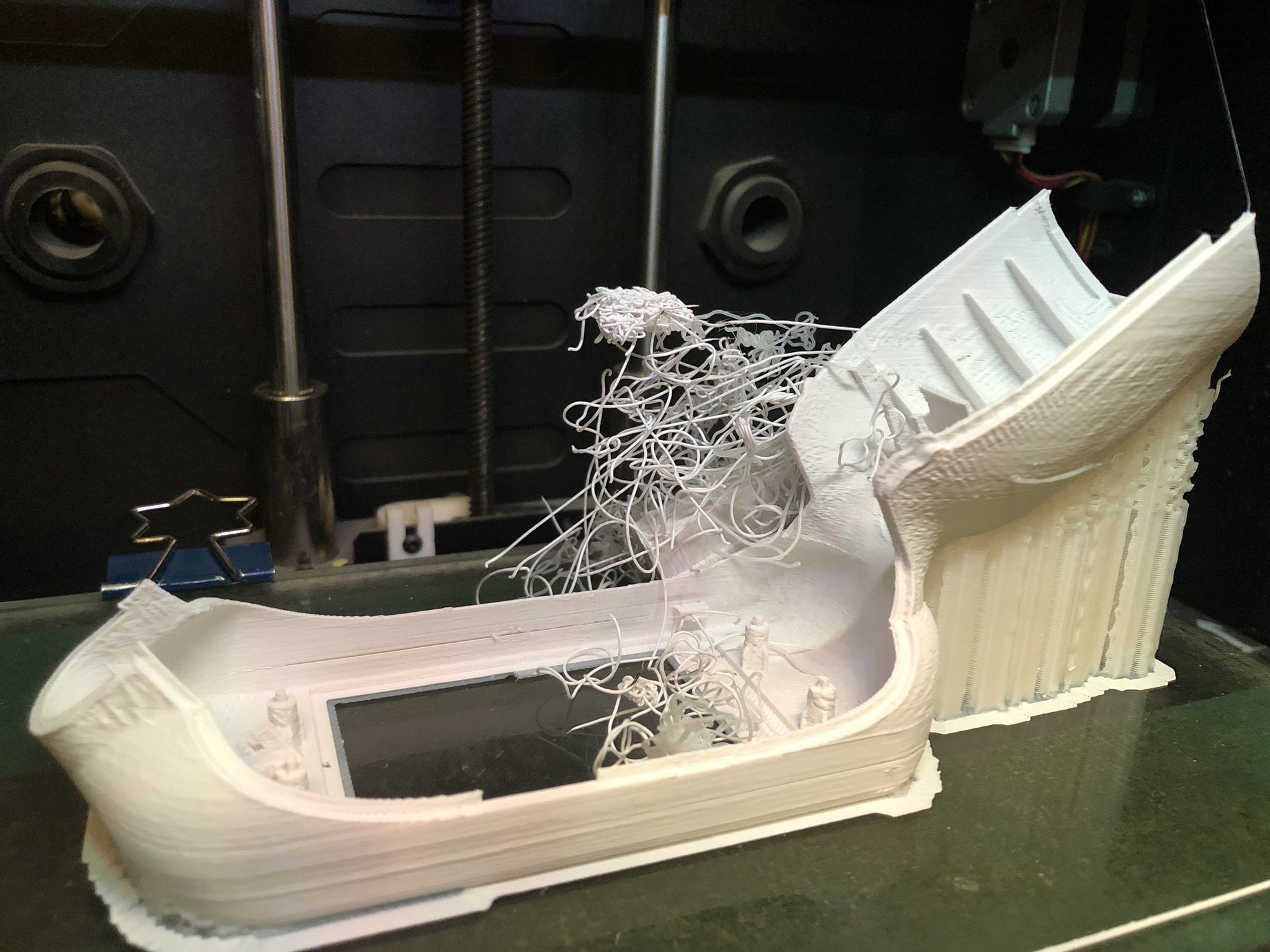

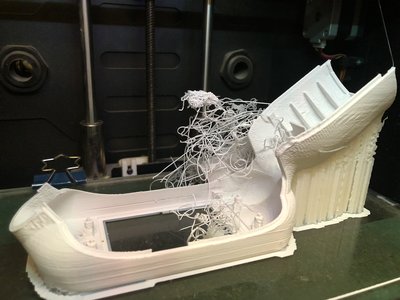

Results of problems are
1) print blemishes and 2) extra plastic purged onto the prime pillar directly causes nozzle interference and as the pillar becomes higher, it can actually knock it off the print bed.
You can make the prime pillar wider but as other threads have noted, that can waste a LOT of filament. For me, it significantly increases the build time.
Pic of prime pillar that got bumped over.
I know there are workarounds to these issues with toolchange scripts, parameter tuning etc, but the point of this post is to make it a lot easier and hassle free.
