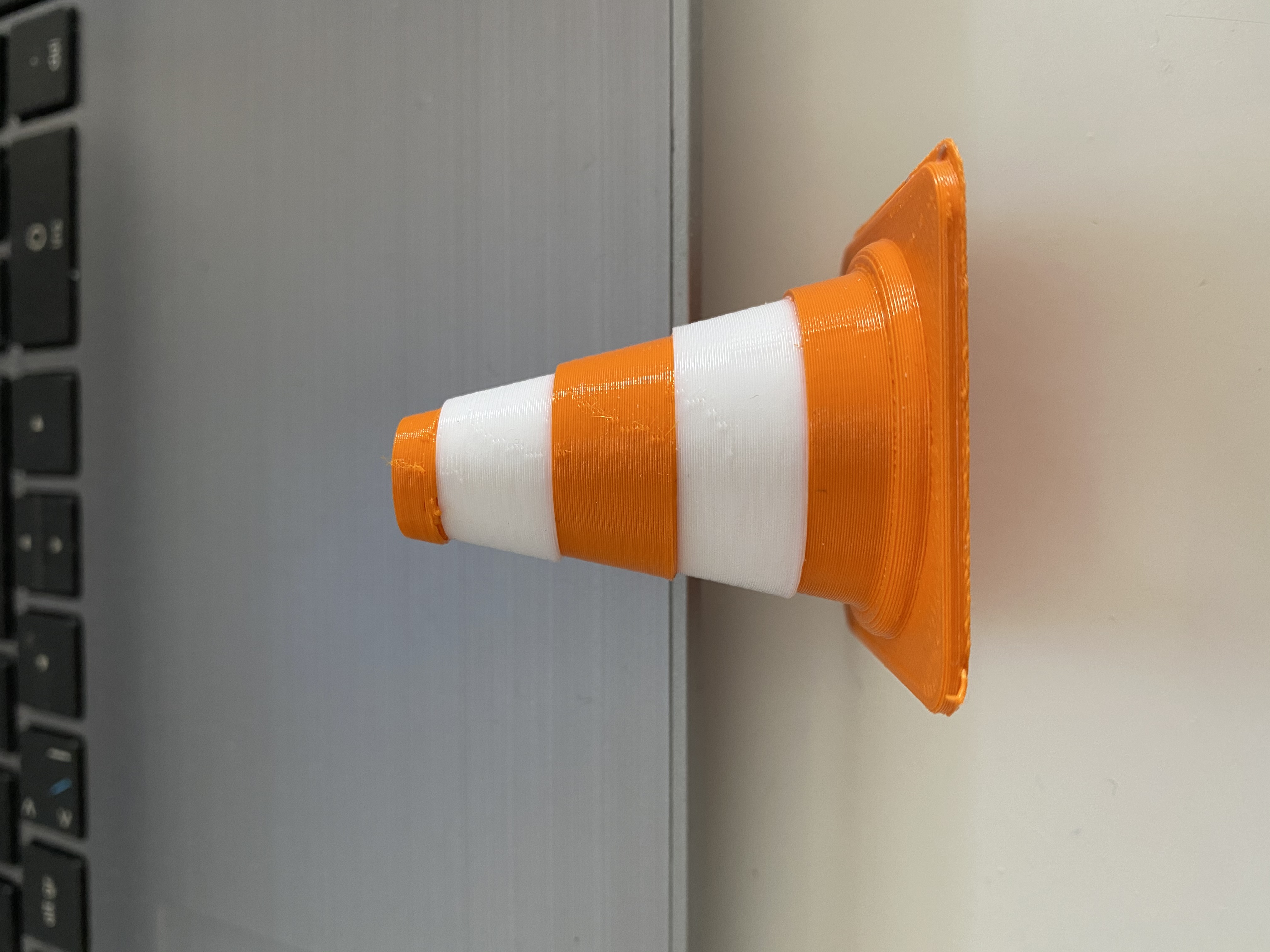

pairair
Joined: Tue Apr 14, 2020 2:42 pm
Re: Flashforge Creator3
Tue Apr 14, 2020 3:02 pm
dronefpvracer wrote:
Thu Feb 20, 2020 5:54 am
Thanks for the different information provided here.
I also possess a creator 3 and having trouble with simplifiy3D and dual color print in simplify.
It starts well, but at every tool change, I'm having an issue just before the back and forth wiping, we can here a noticable noise (like the Y axis "forcing" to the wiping), and it result on a layer shift at nearly every tool change.
I tried removing lines from the tool change script without success.
If anybody have any clue or idea of what's happening it would be really nice.
Thanks :-)
Same issue here on the Creator 3. See picture
/Pär

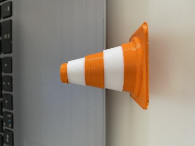

BubbleDeluxe21
Joined: Fri Apr 24, 2020 1:26 am
Wed May 06, 2020 4:45 am
Thanks :-)
I also have the exact same issue. Has anyone found a solution to this in the meantime?
I tried removing the whole tool change script as well as all the retraction, priming etc. commands so I was left with pure print commands and the tool change command M108 T0 or T1. Did that with both S3D and Flashprint. The exact same M108 command seems to cause an issue when it comes from S3D, but not when it comes from Flashprint.
I made an Imgur Album with example videos with and without the issue and a picture of the layer shift.
Any helps/tips/FFF profiles/G-codes are appreciated, this is driving me nuts! :?
