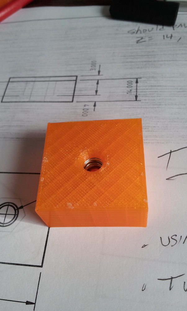

See my post [greybeard] on this page viewtopic.php?f=8&t=11957&p=46890&hilit ... ert#p46890
And a Threaded Insert result image attached below...
(I paused the machine and dropped the Nut into the pocket then, Resumed print to close it up with top layers.
