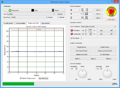

That's odd, I only see the progress bar and % complete in the machine control panel. Am I missing something? I am running S3d 2.1.2 and printing over USB to a Flashforge Creator X.
BTW, I love S3D!
Steve

I only see percent complete, I don't see remaining time anywhere. Does Simplify 3D have this somewhere?

I'm running ver. 2.2.2 and I see the % and the remaining minutes on the control page.

You have to be printing a file that includes time information. Unfortunately, the x3g files do not support this so you will only see percentages, and not a physical time remaining.
