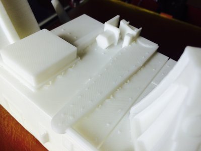

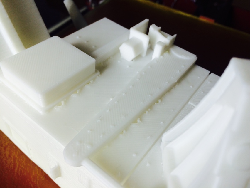

I've found when there is a feature on top of a surface, a top layer of one surface only goes under a feature by one perimeter, even verified in the g code simulator, and even if I've specified more perimeters. This weakens parts, and sometimes I've experienced some curl back too, leaving gaps.
At the very least, I think top layers should reach the innermost perimeter of the layer that's above it. I'd actually like an option to go even further, stitch to the previous layer's next infill line if it's a flat surface, for me, meaning the same Z height across. That way the material laid down is less likely to peel back up while trying to build a boss on it. If I had an ability to place solid infill diaphragms at specific layers, rather than a fixed interval, that would help a lot on many parts as well.

nothing wrong with your request however you really should not be seeing that happen. i have only gotten this a small handful of times if the infill is extremely low and i dont put enough top layers on it.

If my profile is correct, the setting was 10% infill, 5 top layers. This doesn't happen a lot, but this one part took 300g of filament and a 15 hour run. Now I'm evaluating my options, such as switching slicers. Switching slicers is a long haul because of how much work it takes to dial in the settings just right, but if this issue isn't resolved soon, I might need to, at least for parts like this. I like this software a lot, I hope this adjustment can be made.
I contend it would happen a lot less if the top layers were extended enough to overlap better. I've been bitten by weak boss joints before, and it took me a some work to understand what was going on, because it really is a very weak point.

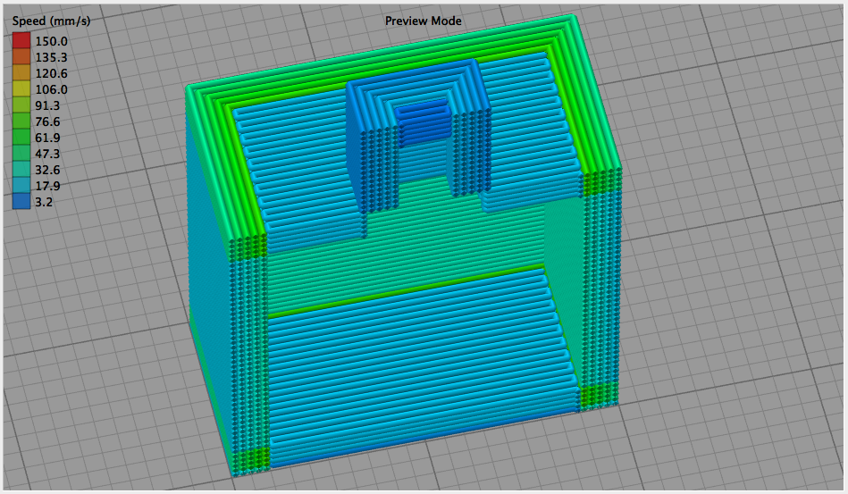

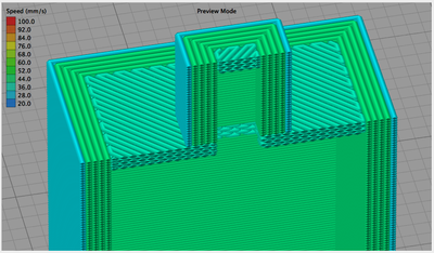

jimmybuckets wrote:I am having a similar issue where when you are stacking one shape on top of another, only the outside loop is conncected to the solid part of the model.
The picture above shows this very obvious slicing bug you're talking about in Simplify3D 2.2.2 which has been there for ages. It happens with all objects that have the features of the above object, even with single STL models, which the above was made from. Here's the STL that makes that difficult to print object:
Box-on-Box.stl
(2.23 KiB) Downloaded 546 times
My picture shows a cross section view. This is a small box on top of a large box. It's 1 STL file, and should print as a single object, and it does, but very poorly. I told the slicer to use 5 shells for all parts of the print. I used NO INFILL to help illustrate the bug. Normally you would print such an object with infill. You can very clearly see that Simplify3D only connects all 5 shells on the outer corners of the print. On the corners where the top box and bottom box meet Simplify3D only makes 1 of the 5 shells connect. All 5 should connect!
This produces an EXTREMELY WEAK POINT.
This is clearly a bug that's been in Simplify3D which keeps getting overlooked by the developers.
I think a lot of people don't realize that the slicer has this bug, and wonder why certain shapes are so weak, and attempt to fix them with lots of infill.
We should not have to use infill or diaphragms to get around this bug.
This should be considered a TOP PRIORITY BUG to fix. In my opinion it's THE NUMBER ONE BUG in the slicer. And yet it gets neglected over and over again. We need to bring this to the attention of the engineers.

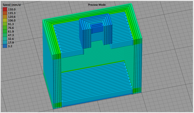

Here is the same object sliced using FlashPrint's ffslicer engine, but viewed in Simplify3D. FlashPrint's ffslicer engine does a proper job. All shells are connected. There is no weak point anywhere.

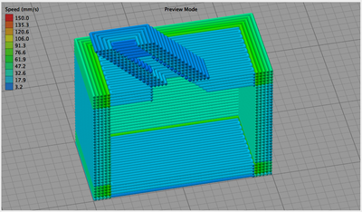

This is again showing the problem in Simplify3D, but this time the top box is slanted. Notice how the right side of the top box is attached correctly, but the left side is not. Strange.
