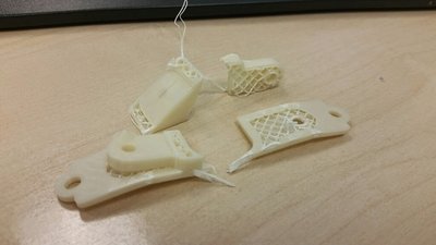

Another example of why this needs to be fixed

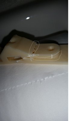

This is with little to no effort to pull apart...this is polycarb/abs blend...almost impossible to rip apart normally without pliers.
