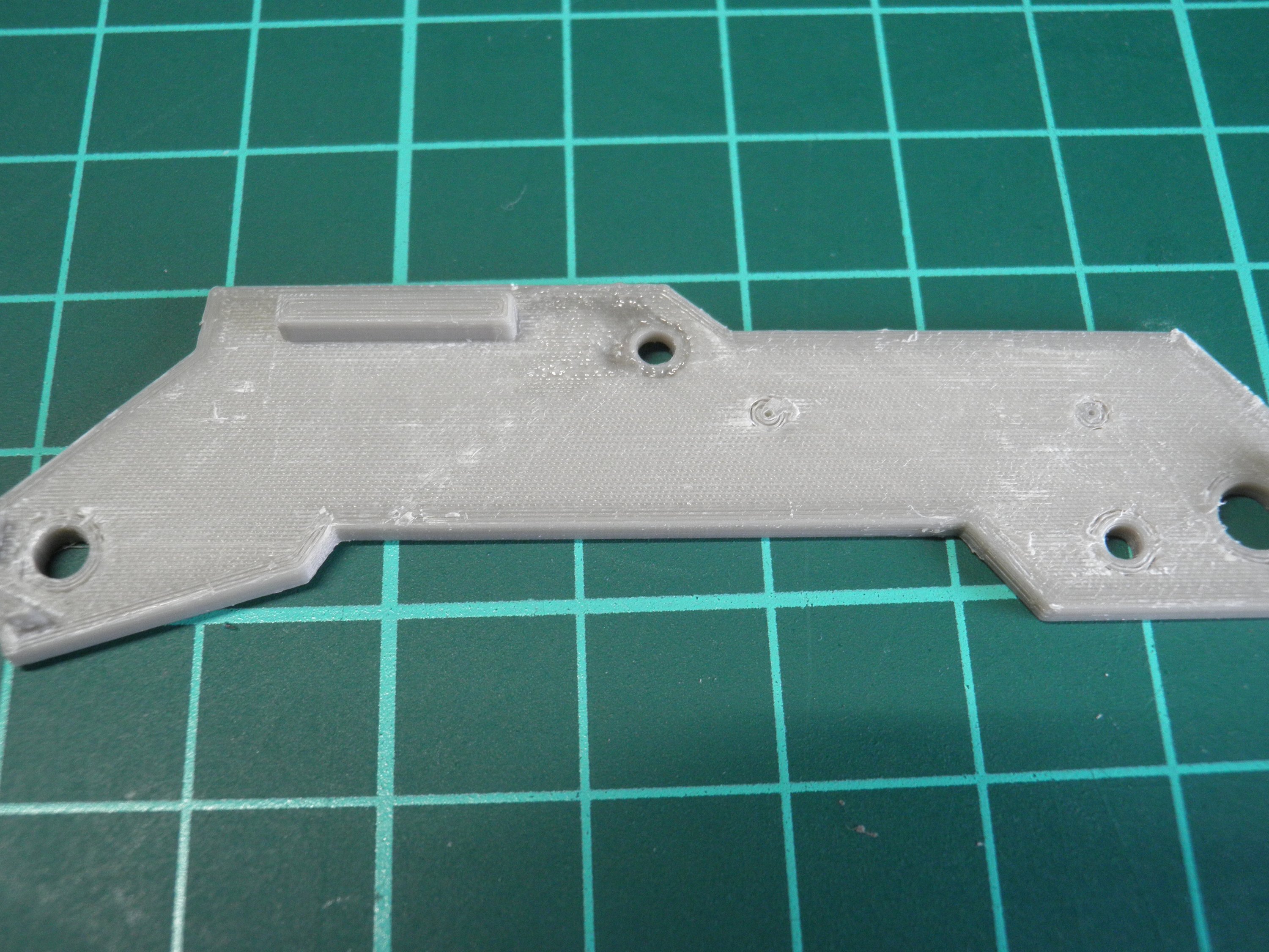

The vertical separation of printed material and support is determined by the number of layers. However, when specifying by the number of layers, separation is not appropriate in many cases. In the case of my printer, when the number of separation layers is 1, the printed surface becomes rough as shown below.
In my printer, at 0.2 mm nozzles and stacking height 0.1 mm, the proper separation distance between raft and printed matter is 0.04 mm. Likewise, if the separation distance from the support is not the number of layers but can be adjusted by the distance, the printed surface becomes beautiful.
The following photographs are printed by changing the stacking height to 0.04 mm and the number of separation layers to 1 in the vicinity of the ground contact surface of the support.
I would like to be able to specify distance in the vertical direction of the printed matter and support :) .
