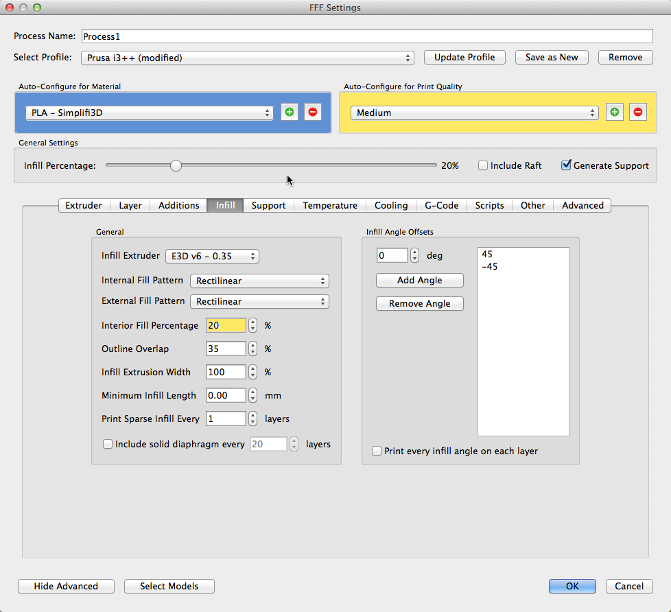

I find it quite troublesome to figure out what setting gets changed by the "auto-configure" dropdown. A very easy to implement and I believe super user friendly is to colour code the 2 auto configure options and they respective parameters....
It would look smth like this:
Maybe allowing the user to select other parameters to be part of the auto config would be useful as well, but probably more difficult to implement....

+1 having the parameters highlighted would be a nice visual of what's available for configuration.
