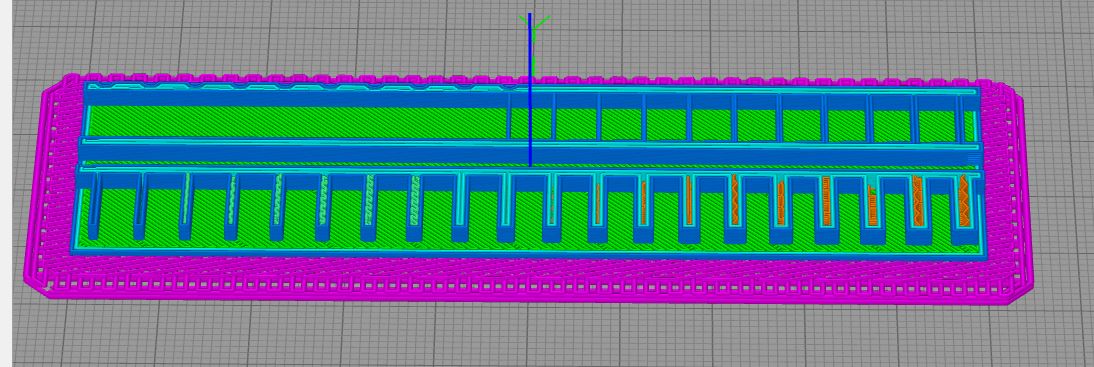

The current behavior, where the slicer leaves a large gap in the part, is not a good solution either. It is not always possible to simply redesign the part to solve this problem, as the part requirements may not be compatible with a single, constant extrusion width. Simplify3D offers no variation in extrusion width for different elements of the print and no dynamic-width gap fill. To make this work, it needs both.Fred B wrote:Cross sections below the extruder width don't currently print. This shouldn't be a surprise because we want accurate prints.
The other slicers that "force" thin walls to print will sacrifice accuracy. Why would we want to print inaccurate parts? It's more accurate to design features to print properly in the first place.
If they did add a feature it could be called "inaccurate thin wall mode"
In contrast, Slic3r (which has its own issues, to be sure), nicely lets you vary the extrusion width for outer perimeters, inner perimeters, infill, etc.
