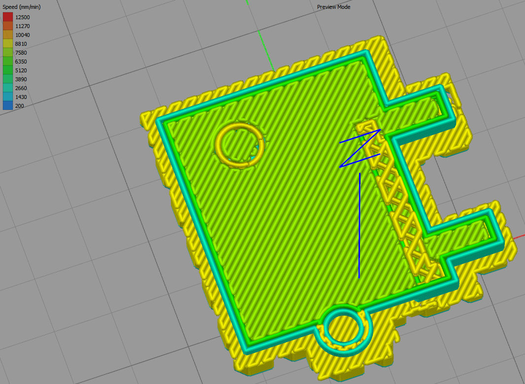

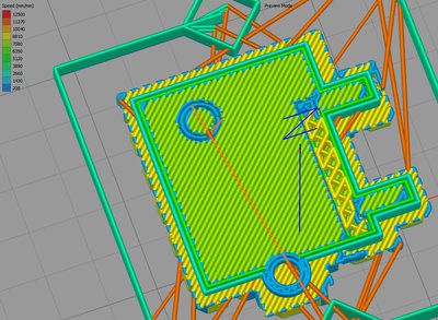

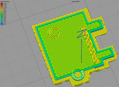

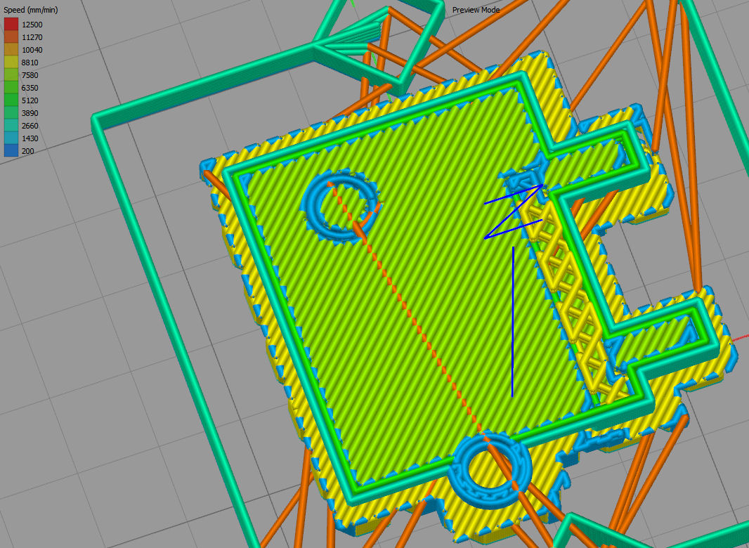

You may be able to do this:
- Scan your GCODE file before converting to .X3G/.S3G for any E segment of your choosing of which anything less than will have to run at a slower speed.
- Add Fxxxx (any speed you want) to the end of each of those lines
- If the 'next' extrusion line is above that segment, you'll want to add Fyyyy that puts you back to the speed you originally had (this may require C++ or coding language, but some of you have abilities to do this via other means)
This method allowed me to raise my acceleration levels back to 'normal' values, allowing a much higher speed for all my regular prints, yet slow down during small arcs AND when filling in spaces between narrow shells, which would usually cause the bot to shake. I can now get much cleaner bosses and screw holes, arcs and corners which more closely match the tolerances in my model.
S3D just needs a parameter to automate this for you.
BEFORE:
AFTER:
