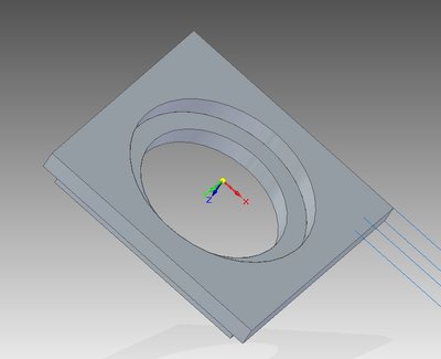

I would also recommend a feature like this. I would be nice to have a feature for bottom, inner and top of the outer shell.
That means :
- Extern Fill Pattern TOP ( Reclinear, Concentric)
- Extern Fill Pattern INNER ( Rectlinear, Concentric)
- Extern Fill Patern BOTTOM ( Rectlinear, Concentric)
That will solve the problems the guys had before.
Also it gives more strength to some modells with overhangs.
The attached picture is a testpart for a ball bearing. It is printed with the big ring on the botton, so you will need support. ( you are facing the bottom side)
The surface of the bottom of the inner ring comes out best by printing concentric. Anyhow the strength of the structure would be
much better if the next layer of the outer shell could be changed to rectlinear (I am using 3 Outline Shells )
. I have also attached the STL.
