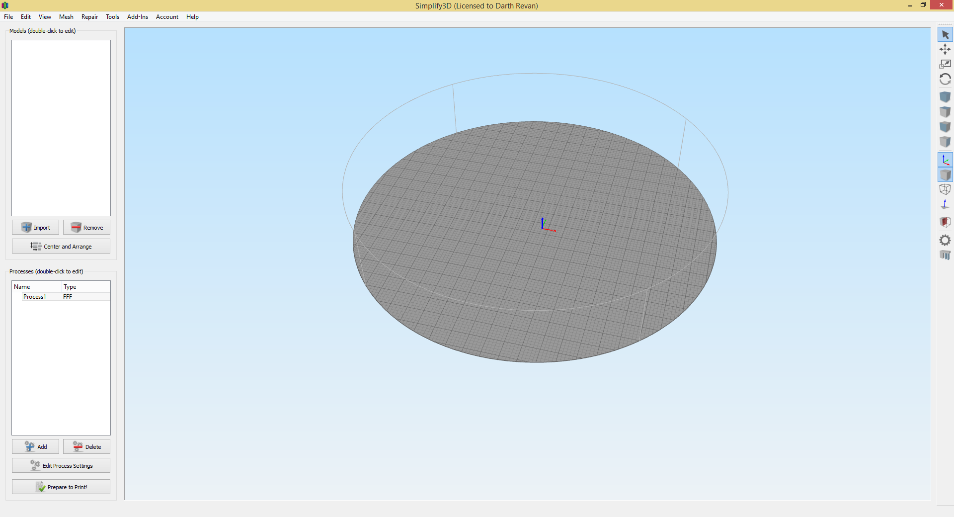

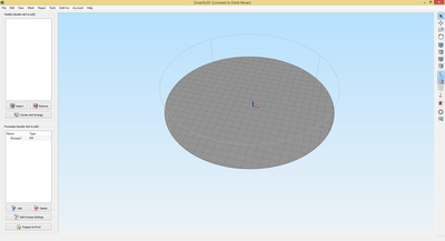

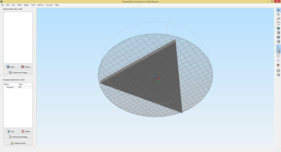

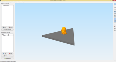

I have been wanting to do this also with my Kossel it has the large triangular print bed! does anyone have a screen shot of what this looks like after doing it?
DarthRevan
Re: Custom Bed Shape?
Jamesbuzz wrote:
Paul_W wrote:I am considering purchasing Simplify3D. Is there an option now that will allow me to specify a custom bed shape?
I have a large format Delta printer that has a mostly triangular bed that's 17" across.
With Slic3r I can import an STL with the bed shape, and then it is easy to position large models.
Can S3D do this now?
Thanks
Pics:
Above with grid
Above with grid
Under with grid
Under with grid
Grid Disabled
