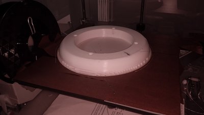

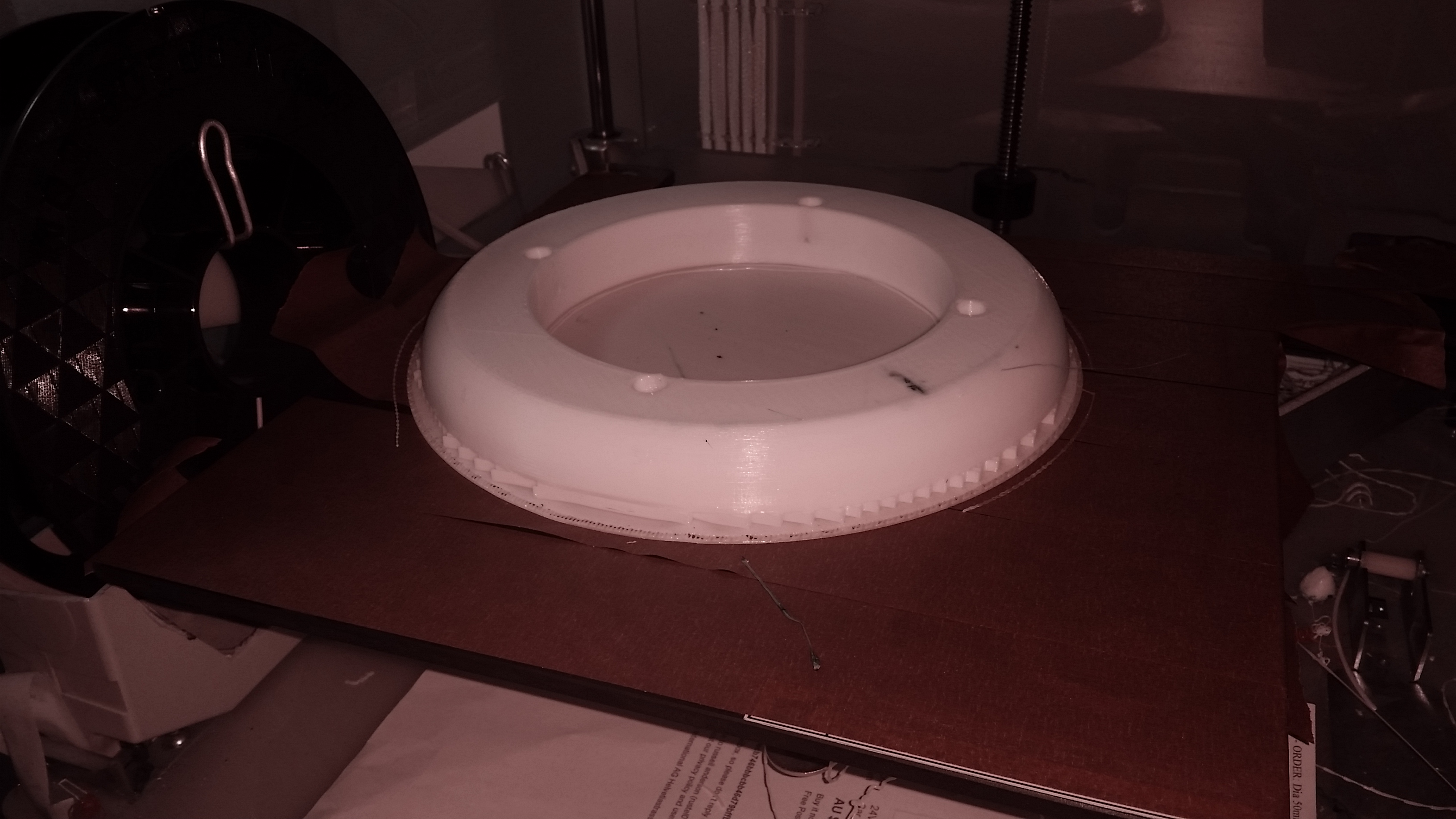

i don't use pla as my prints are mostly patterns for sand casting and i find pla harder to post process.
The pic is what i printed with the fff file i uploaded, 0.3 layer, heated bed, abs. support and raft came away very easily. best prints i've been getting. but still a lot of room for improvement.
print in abs .3mm layer with the fff file uploaded
