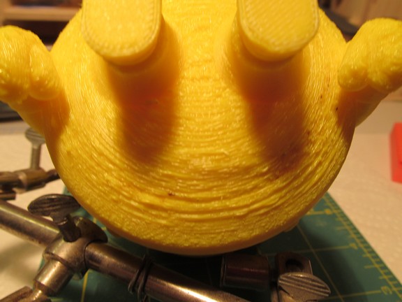

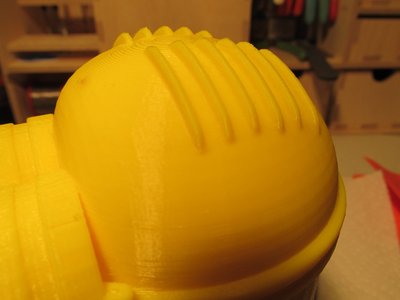

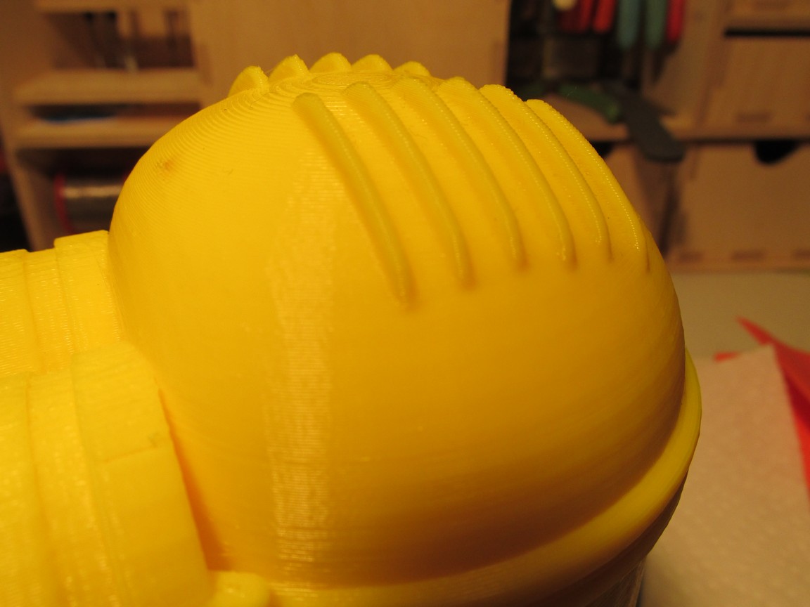

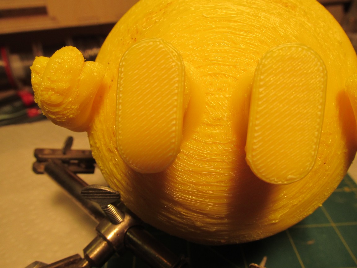

My parts look under filled where ever they meet the support structure. (see attached photos). The surface of the part where it meets the raft is good and the top surface that has no contact with support structure is good. I have the same result in ABS and PLA material. Any ideas as to the cause of this?

top surface is filling correctly and is smooth
bottom of shoes are smooth where they were attached to raft
rough surface where support was attached

I would recommend trying a lower layer height in that area and perhaps also experimenting with some dense support structures. If you want the absolute best results, using a dissolvable support material allows you to have the best finish from what I've seen.

Lowering the layer height and printing the outlines slower will help
