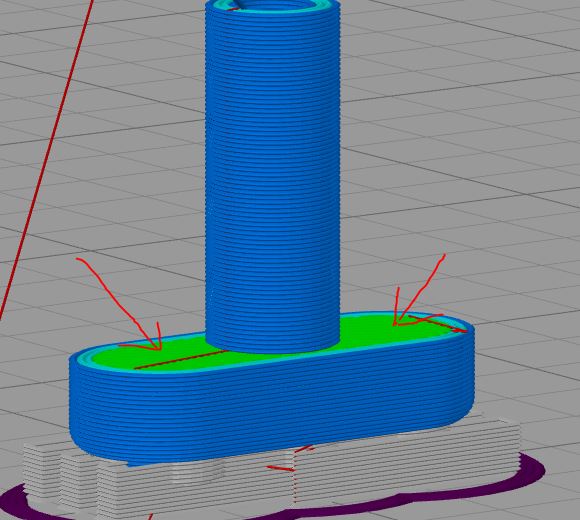

What must i set in the Options to get a Outer Layer on top of my Model?
I tried different Settings without success.
What Settings is responsible for that?
See the Picture attached.
Matthias
Re: Process settings
This isn't related at all, so I would suggest making a new thread for this question
