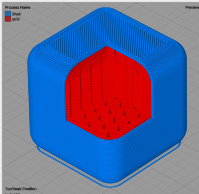

So, not everyone quite understood what I wanted to do - "The Bum" had an accurate description of what I was trying to do. RoboDLC was on the right track... which hinted at a solution:
Two parts - a shell with a wall thickness*2 and an inner portion. I simply removed perimeters on the inner portion, and only am printing the perimeters top/bottom layers on the shell.

It turns out you CAN print infill without perimeters:

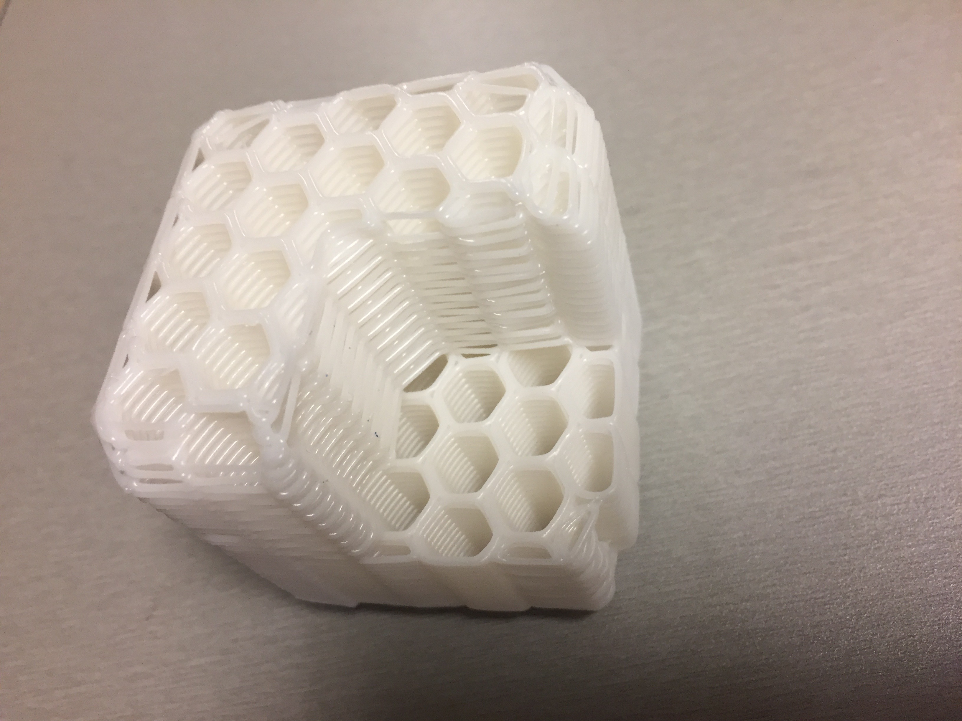

I decided to print it (Printrbot Model 3 kit, Mosaic Palette+):
Before:
After some cleanup:
