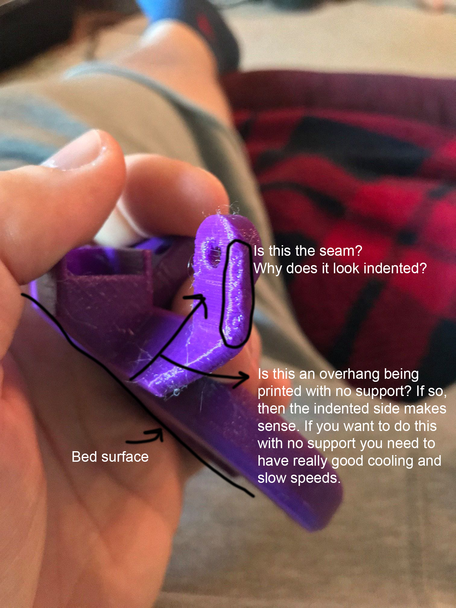

So i just completed my first larger print using PETG (eSUN solid purple PETG), and ran into a few issues that i was hoping y'all could help me with! I've included a number of pictures, with each picture of the print (the inverted Ciii cooler) highlighting an issue that i saw, from the stringiness to the bumps on the main top layer to the inconsistent layering to the (what i think) is bad bridging...i've also included screen shots of each page of my settings in Simplify3D...any help or advice would be most welcome! I've been trying to dial in my PETG settings the last few days, and while i've made some major improvements in some smaller prints (i've been scouring the forums and advice pages about PETG), this larger one definitely showed me that i am not quite there yet. Thanks in advance, i very much appreciate the help!! :)

Apologies for double-posting, but i think i accidentally deleted my initial post, so here it is! I also realized that i can apparently only upload 3 photos at a time, so i am just uploading three showing some of the issues i'm running into and i'll post my settings below.
So i just completed my first larger print using PETG (eSUN solid purple PETG), and ran into a few issues that i was hoping y'all could help me with! Each picture of the print (the inverted Ciii cooler) highlights an issue that i saw, from the stringiness to the bumps on the main top layer to the inconsistent layering to the (what i think) is bad bridging...i've also included screen shots of each page of my settings in Simplify3D...any help or advice would be most welcome! I've been trying to dial in my PETG settings the last few days, and while i've made some major improvements in some smaller prints, this larger one definitely showed me that i am not quite there yet. I am printing on a Monoprice Maker Select Plus with the MicroSwiss all-metal hotend .4mm nozzle. Thanks in advance, i very much appreciate the help!! :)

In general, I would say your biggest issues are speed/cooling with some tweaks needed to extrusion.
Bottom of Part
From what I see, you are printing with no supports, which explains the extrusion mess I marked. If the bed is 75-80C, there's no way those layers are cooling down enough not to deform (they are way too close to the bed). So you get a very messy perimeter, and that plastic is going to coat your nozzle and probably get deposited else where on the part and cause additional issues. If you want to do that with no support, you need to print the perimeter slower for this section (5 mm/s) and ideally smaller layer heights (~0.1 mm, or 0.05 mm if your printer can handle it). That's where Simpilfy3D variable settings come in handle. I basically never print a part with one profile, unless it's a fast and sloppy run. You are also going to run into a barrier somewhere (at some point) with using a stock cooling fan. I find nearly every commercial printer is good for PLA, but once you get into other plastics, various design issues start to show up. But ultimately, it depends on what you're doing and how fussy you are.
Side of Part
It looks like you are trying to print this feature with no supports too. I didn't see any support settings in your profile. If you are, then you need to slow down on the overhangs so the plastic doesn't drupe. You have a speed and cooling problem here, if I'm understanding how you printed correctly. Usually you want to be around 5 mm/s for doing stuff like that without supports, also, the lower the layer height the more subsequent layers make up a curve (smaller incremental layer building), which helps a lot for no support PETG prints. I'm not sure why your bridge speed multiplier is 125%. You should be slowing down for bridges. I would recommend looking at variable settings and make a different profile for the more difficult sections. One-size fits all doesn't work if you want beautiful PETG parts.
