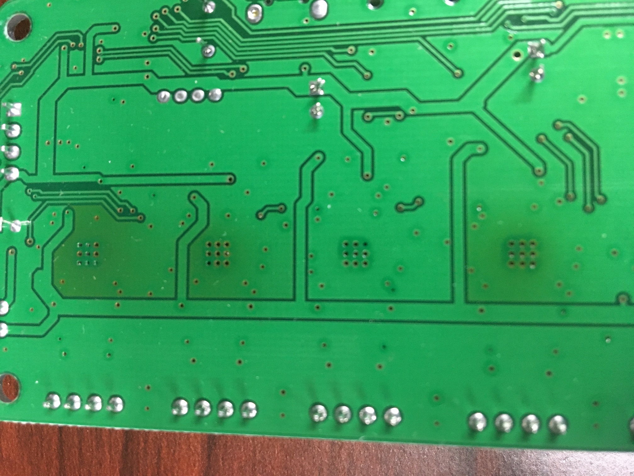

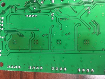

Do the actual Stepper Driver boards go bad? Is that a common problem?
Specifically, has anyone resolved their printing issues by replacing a Stepper Motor DRIVER?
I'm not sure if I have a bad mainboard, bad stepper motors, bad Stepper Motor Drivers or what.
It just seems as if the printers can no longer find their way and every attempt at printer (on both printers) ends up with a mess, shifted prints, over extrusion, under extrusion and a host of problems.

As you can see, I've nearly exhaustd things to check. That's why I'm beginning to believe it's in the electronics. Such as a failing Stepper Motor Drivers.
Of course, at 3,000 plus hours it could also be failing stepper motors I suppose.
The Coils in the stepper motors all read about 7 ohms.
Once in a while, the LCD display will display trash during a print and once, the print stopped due to it.
I think this would point to a mainboard issue?
