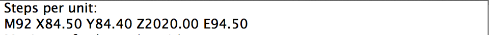

This will display your current steps per mm. It is good to write this information down or take a screenshot of it to revert if necessary.

Good info, 10KOhms did an adequate job describing this process. Just wanna clarify the G92 Exx,the E stands for Extruder, there will also be an X,Y and Z. In addition, the xx he used is a placeholder for a variable, don't be surprised if the actual steps per mm you use is 3 digits long (xxx).
