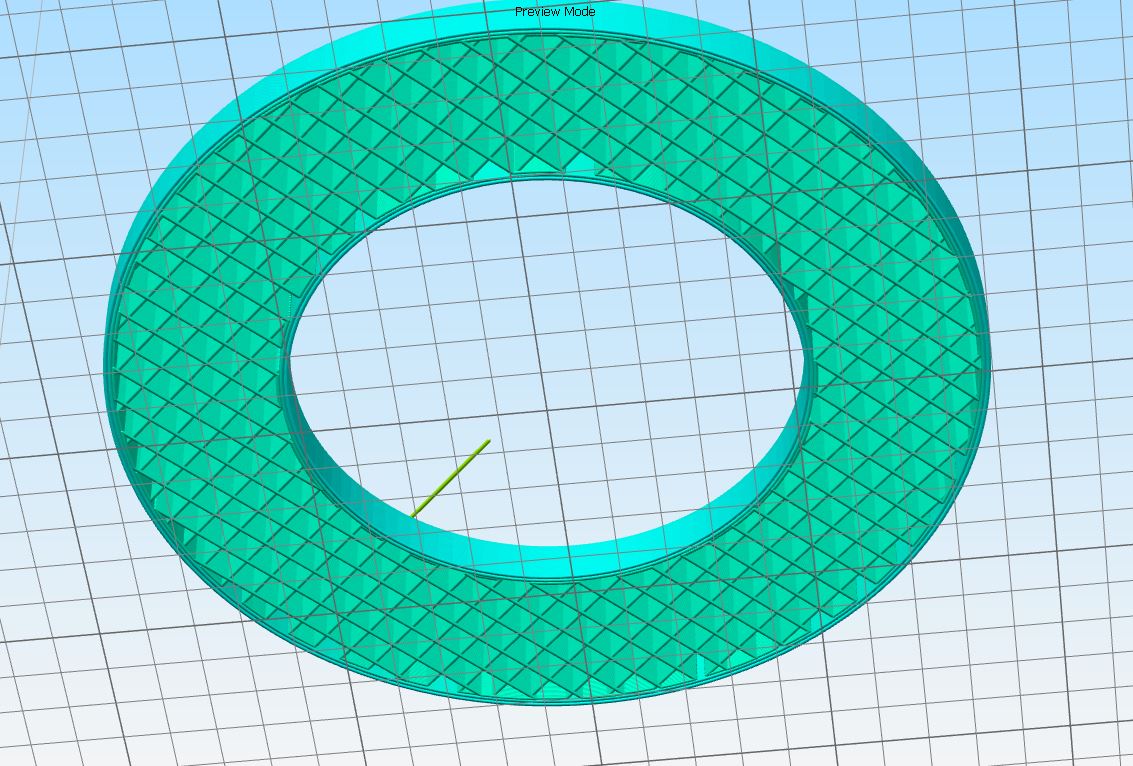

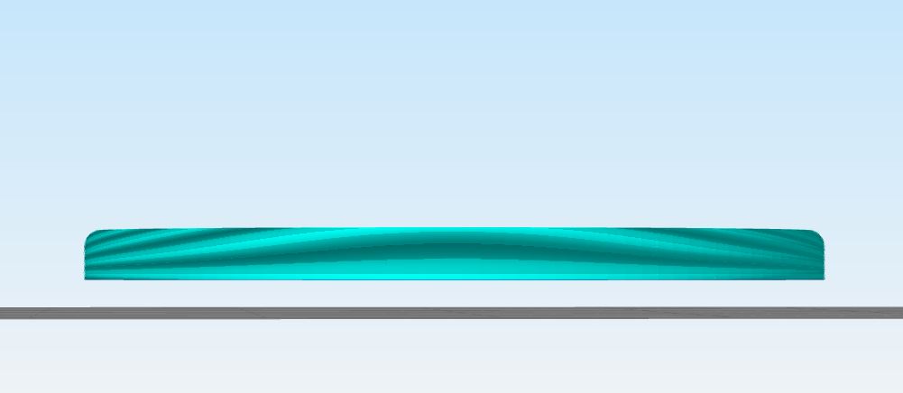

Il would like to use the feature "start printing at height x mm". When I do that, the gcode shows indeed a cut print starting at the required height (
). My problem is, the printer is still making the bottom layer.

I cannot use the option (bottom layers : 0) since it affects all the bottom layers of the part (like overhangs).
Ideally, my goal is : If I have to stop a print (power cut, or other issue), I wish to restart it by setting the height already printed, so the printer can restart the print like nothing happened. For that, I do not want the printer to make a new "full layer" when it restarts.

Use the variable settings wizard to set the first process to start where you want to start and then stop 3 layers up (+0.6 mm in the case of a standard layer height of 0.2 mm). Set the bottom solid layers of that first process to 0, then the upper process will add bottom solid layers where needed, but thanks to the added seamless process transitions added in 4.0 you won't see solid layers added in the parts of the models where the process split happens.
