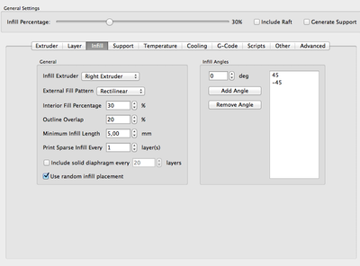

Hi there,
I'm using Simplify3D for some days and running into some issues. After slicing models I recognize some strange offsets at the top layer (view picture for details.). Anyone has an advice to fixing this issue?
cheers,
Markus
settings 1
settings 2
Slicing Issues in the red circles

Layer tab, change External fill pattern to Concentric.

JoeJ wrote:Layer tab, change External fill pattern to Concentric.
still no difference. That is the file: http://www.thingiverse.com/thing:82478
Any other ideas? =(
Re: Slicing rough top layer at some points?
Sat Jul 19, 2014 11:51 am
I think if you posted a picture of that same area after making that change, you would see that it most definitely makes a difference. However, you weren't very clear in your original question. If you're asking about the fact that the layers seem to be offset more and more from the layer below it as you get to the top of that rounded belly, that's just how 3D printing works. Try making a hemisphere out of legos - you'll see what I mean.

JoeJ wrote:I think if you posted a picture of that same area after making that change, you would see that it most definitely makes a difference. However, you weren't very clear in your original question. If you're asking about the fact that the layers seem to be offset more and more from the layer below it as you get to the top of that rounded belly, that's just how 3D printing works. Try making a hemisphere out of legos - you'll see what I mean.
Thanks Joe,
the lego explanation was perfect. ;) So there is no other way to make it smoother. Not a big Deal, but it would be great!

w0nk1,
You might use a second process, starting near the top, with a smaller layer thickness. Let's say you run most of the part at 0.2 mm layer thickness. Apply a second process, starting a mm or so from the top with an 0.1 mm layer thickness.
Like using the thin Legos where the curvature dictates, but the regular thickness Legos for the bulk of the build. You get the speed of the bulk layer thickness for the vast majority of the part, and the detail (and slowness) of the thinner layers only where you need them.

nice suggestion Dale, I remember when I first started using s3d, I was quite unfamiliar with using more than one "process" per part, but now that I know I can add multiple processes per part, I find myself doing it consistently to really fine tune how i want a a part to print out.

thanks for your advice.....but i guess it won't change something, I already built the whole minion with 0.1 layer thickness and still the "rough" part. But you both are right, I need to learn more about multiple processes ;)
