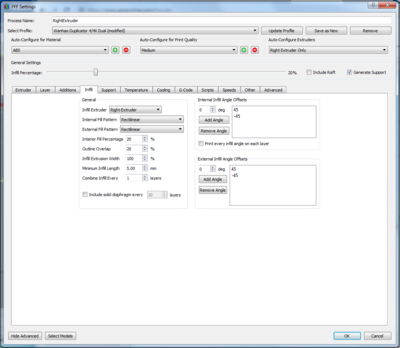

I'm attaching pictures of the Extruder, Layer, and Additions pages, these are the only settings I actually changed. I've also discovered since this post that I have some bed-leveling issues to address.

Only thing I see right off is increase your first layer height to 120 or so otherwise you'll fight with it since the first layer will be so thin.
I also reduced my normal print speed for a 0.4mm nozzle from 40mm/s to 20mm/s for the 0.2
