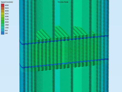

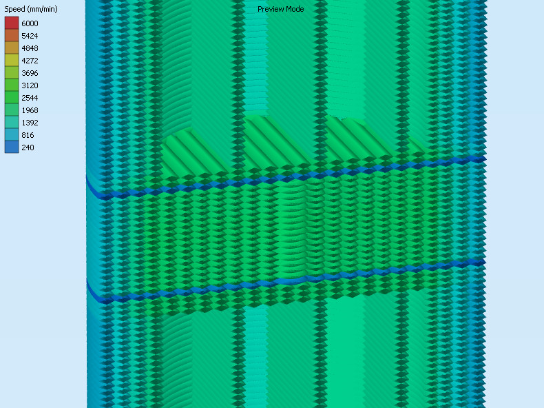

Here's an example of method 3. This is a cylinder (cut so you can see the interior) that is 100 mm high. From 50-55 mm I made it have 100% infill. The rest is 20% infill.
- Example of using 3 different processes to make solid infill at a specified height.
