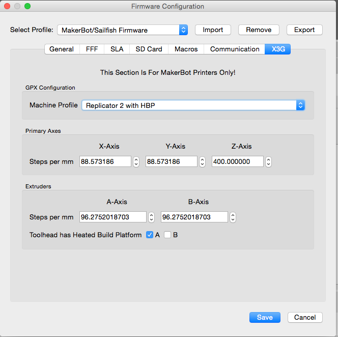

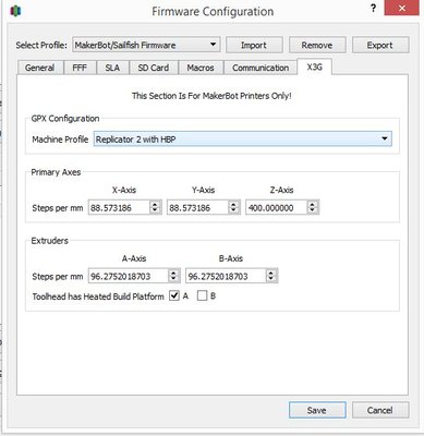

It sounds like you did things correctly in the Temperature tab, however one thing that's really important to change as well is to go to Tools-->Firmware Configuration and then select Replicator 2 with HBP

After adding a temperature controller for the heated bed, try going to Tools > Firmware Configuration.
Then in the X3G tab, instead of Replicator 2, try the config for Replicator 2 with HBP

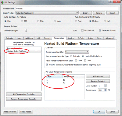

To start the heatbed again, after the extruder has reach temperature, I have done this:
Open FFF settings, select Temperature
Select "Heated Build Platform" Set temperature for layer 1 some 10-15 deg. C more than you want when printing and check the "Wait for temperature..........." box
Set temperature for layer 2 to the temp that you want when printing.
So the Rep2 starts to heat up the bed to 50 deg. C. When the temp. is reached, it starts to heat up the extruder and at the same time cut off the bed.
The bed temp. start to decrease slowly.
When the Rep2 starts to print layer 2 it turns on the bed again and also keep the power on to the extruder :-)
Notice that the bed is not shut down when the printing is finished.
/JJ
