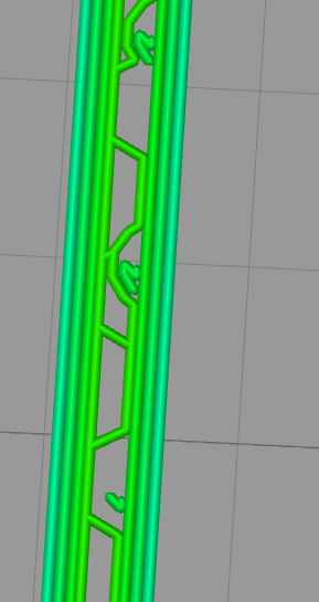

So is there a way, through post processing, to remove lines from the gcode, where there are unconnected extrusion lines shorter than some threshold length (extrusion lines that are between xy movements?
This is what I'm talking about.
These tiny bits don't usually come out as they should (at least in PLA). I believe this script: https://github.com/alexrj/Slic3r/blob/m ... ecimate.pl does the same thing for slic3r.

It would really be better to put this question in a separate thread, but there is already a minimum infill length setting that would accomplish this.
