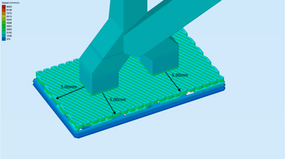

Raft Offset:How far away your part the raft will extend out to.

When using a raft one setting says how far from the part the raft extends and I am wondering how you determine this distance from the part? It appears that you use a shadow image from a Z axis point of view. This results in way more raft then is needed for a part that has a small contact footprint but is a much larger part overall. Can you either change this distance to a distance from the actual bed contact footprint or add a second setting for this.. What I am printing is a ring for BB8 and it is a curved piece with a very small contact but a lot of overhang resulting in a very large raft when what is really needed is a fraction of this area.
