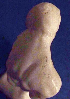

This is my first project using this software, and I am pretty confident that I am missing a very small detail in the setup.
My problem is that I cannot get an even thickness skin. The top surfaces all have holes because the skin is so thin.
Glad to hear you got it working! Good work jimc!katapault wrote:Thanks for the input. I tried so many variations and ended up attaching the wrong factory file, sorry about that.
What I ended up doing was splitting the model into 4 parts and adjusting each section accordingly and it printed great. .
One thing to note is that jimc is 100% correct, the holes were being caused due to the fact that this area is a perimeter and not a top surface.
Thanks again for the help, it will take a while to learn all the options and adjustments that are now available to me in this software.
