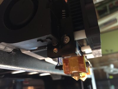

omega-00 wrote:The 'blue' plastic base that was mentioned is simply a PC sheet (similar to BuildTak) made by FF.
They been shipping with those for a while now.
Here's what the new extruder head looks like:
That is identical to the head on my PowerSpec Ultra. The PowerSpec Ultra is Microcenters house brand. It is manufactured by FlashForge. It is a creator pro with dreamer brains from what I have read. Maybe they liked the powerspec design better they adapted it to their own creator pro.

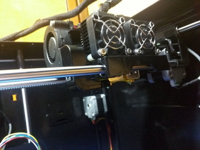

I just got my "Creator Pro" and I also have the problem that printing with the left extruder ist not possible with Simplify3D. The priming produces a big blob in the right side, and the print does not work. You can see in the preview screen that the head wants to move more to the right than it is possible.
I have chosen the profil "Flashforge Creator Pro" of course. I also resetted the configuration multiple times.
The extruder head looks also different than the pictures already posted. Have a look:
Extruder Head Flashforge Creator Pro
