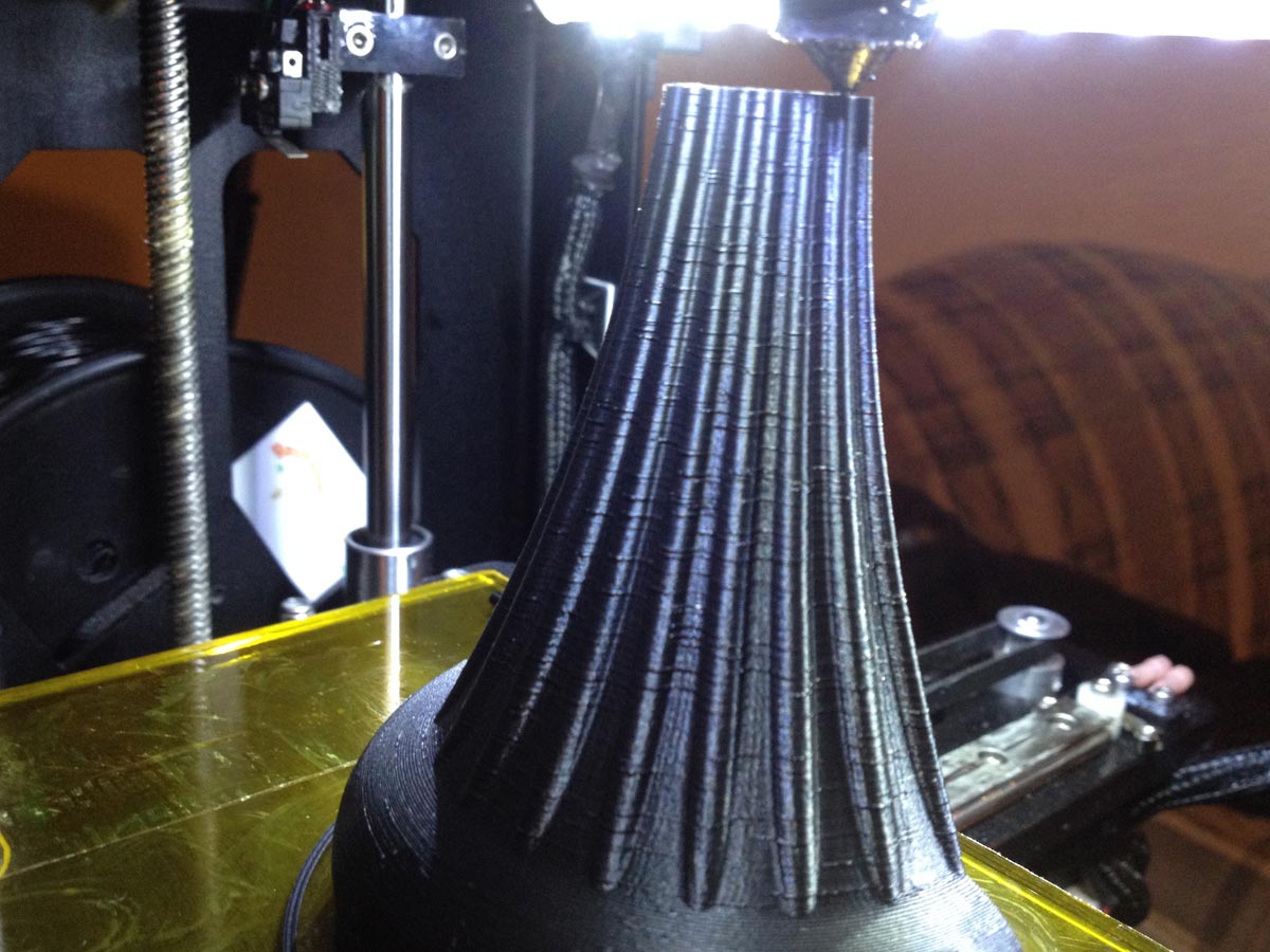

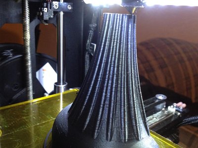

thats funny, when i was talking to clayton on sat i brought up the same thing. i have managed to clean up the print quite a bit by reducing the multiplier and using the coasting but its still there and im not sure what its from. i feel i have gone as far as i can with adjustments but im not sure really. i attached a pic of a part i have printed prob 14 times and i have gotten it better each print but now i have hit a wall. its possible its the filament and has nothing to do with creator or settings but i dont know. i just ordered a new roll from makergear so i can try a different brand and compare. the bumps in the pic are enhanced by the down light so it makes it look much worse than it is but it certainly is something i would like to narrow down if i could. part is done in abs.

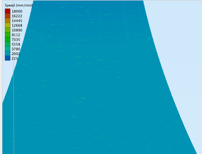

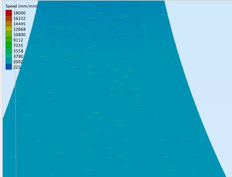

here is another pic of my low detail preview of that same part but zoomed in real close. im not sure what that is but it certainly looks like what i have on my part.

Yep, that's exactly my issue. Coast, retract,... would affect blobs at layer changes. My burrs aren't at the start of new layers. I've tried several filaments as well.

well i figured out what those lines were in the preview pic. that is the coasting. its showing where the extruding is staring and stopping. i got my roll of makergear abs and that gives me the same results as the other cheap abs i am using. still have the blobs. i am going to try a couple more things and ill see what the results are. what is funny is i put my new extruder motor on and it seemed to make the problem worse. there was so much slop in the old motor that now i am thinking i am retracting too much and causing a delay before the jump and making a blob.

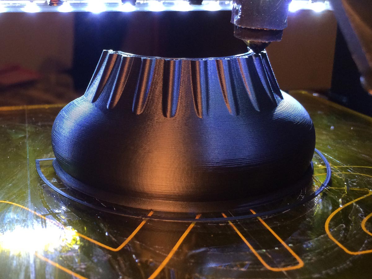

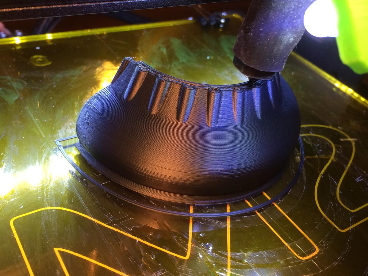

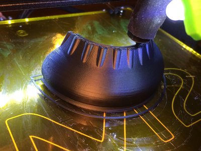

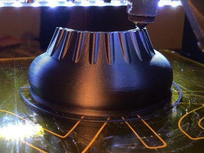

thanks dale for the input. yeah this part is 100% made of arcs. i havent bothered to try the g2/g3 because i thought it was not supported. my m2 is only a month old now so if yours is good then mine should be i guess. ill try it out. the blob i am getting is at the beginning of each line. i have worked on it tonight. tried the bottom 3/8" of that part about 10 times with different settings just tweaking and fine tuning each time. i basically nailed it on this last one. i was randomizing the start points which scattered those blobs all over the place. with all my experimenting to make that start point nice and clean i have found my retraction to be set at 1 but the coast really helps the most and is set at 2.8 which i guess is kinda high but i am watching the line go down and its not running short at the end at all so i guess thats fine. multiplier .88, temp 220, makergear black abs. i turned the random start point off so now my print this time is super clean, almost flawless. all i have is a real super small line where it starts each layer. as a matter of fact, its printing right now and this is the cleanest print i have ever done of anything to date. here is a pic so far.

Looking REALLY nice! I'll take a look at my coast setting -- might be higher than I'm remembering... and I've been printing only MG black PLA so far. I haven't opened up my roll of ABS yet -- I've been watching the threads about adhesion and bed temperature and enclosures and trying to decide what I might do to set up for ABS. For now, PLA is doing what I need.
You're getting layer-to-layer alignment on your arcs better than I was getting on the torture test part before I enabled G2/G3. Could very well be that you don't need it, or there's something about the torture test object in how the columns are laid out in CAD. But for me, enabling G2/G3 was like night and day --- the columns are just as nice as can be now, and with the better alignment they are much stronger. Before I could just push them over.
In your second image, I'm looking over at the far right of the part, where the edge is back-lit, and zooming in on the layering. There's just enough jaggedness there that I would suggest you try printing with G2/G3. If it doesn't look better by the time you've printed to the same height as in your pictures, you can cancel it and say the heck with it. But give it a try, at least!
