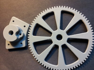

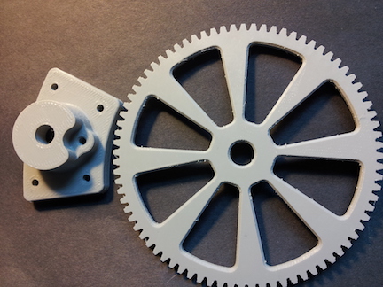

greybeard
Posts: 60
Re: Cant get these gaps to fill
Mon Feb 20, 2017 1:35 pm
I print many parts like yours for my Arduino gizmo’s - holes for buttons, switches, LCD, screws… these Printing tips may help… (some mentioned by others)
PLA Material - I won’t use Hatchbox again (I tossed out several spools). I prefer eSun.
Print Temp: When the FF box says 210max, I use 225. When box say 220max, I use 235C.
Bed Temp: 50C until the part is done (otherwise, part can release from bed and move)
Outline overlap: 25%
Infill density: 25%
Infill angle (add one for -45deg to get good cross-hatch). Infill supports the top layers
Min infill length: 1mm
Infill: Rect (both internal and external). Depending on your part, internal can be Concentric)
Extrusion Mult: 1.02 to 1.05 for PLA
Extrusion Width: Manual
Ensure bottom layer bonds to bed and, you’re better off setting the bed/nozzle gap using a cigarette rolling paper (prefer the silk kind like ZigZag - it’s thin) for a shim.
With those parameters, your results could be like shown in attached photo (note: these are ‘as-printed’ not yet cleaned up. Zero gap’s and, the super thin nozzle-gap ensures a glass-like bottom layer, as seen on the gear’s bottom (shown). For more accurate dim’s, increase the First layer height to ~125%
Print Example

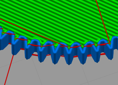

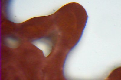

prototyper
Joined: Sun Apr 02, 2017 9:04 am
Sun Apr 02, 2017 9:26 am
Hi, I'm also printing gears, module 0.5 and I'm still having some fill issues.
Maybe I reached the limit of the printer (FF Dreamer 0.4 nozzle).
The gear itself looks not bad, but the teeth are not filled, so it won't be a very stable construction.
The pic attached is made with a x4 lense on my microscope.
Any hints which "screws" I should turn to get a better result ?
Does any one has a settings proposal ?
thanks
Stefan

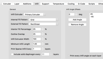

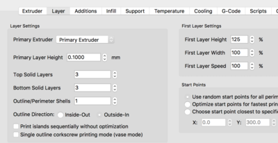

greybeard
Posts: 60
Sun Apr 02, 2017 2:15 pm
A couple of comments…
It’s printed plastic and subject to variations of machine, setup, belt slop, print and slice parameters.
With 0.4 nozzle, all you can do is quasi-trick s3d by changing the nozzle tip size in s3d (try 0.3… others) But, don’t expect miracles. You may be able to change the nozzle on your machine (most machine facilitate this).
Consider that a 0.5 module tooth has nearly a pointed tip and root - with nozzle tip of 0.4, the print won’t be accurate but may be all your project needs… I use my printed gears for telescopes and are deadly accurate for the purpose.
When you say "not stable construction" consider that shell, though not filled, is strong enough for something a gear with 0.5module would be expected to take the load (face pressure). Also, graphic slice renderings are not exactly the same as a printed part.
You should tinker with parameters such as: see images
