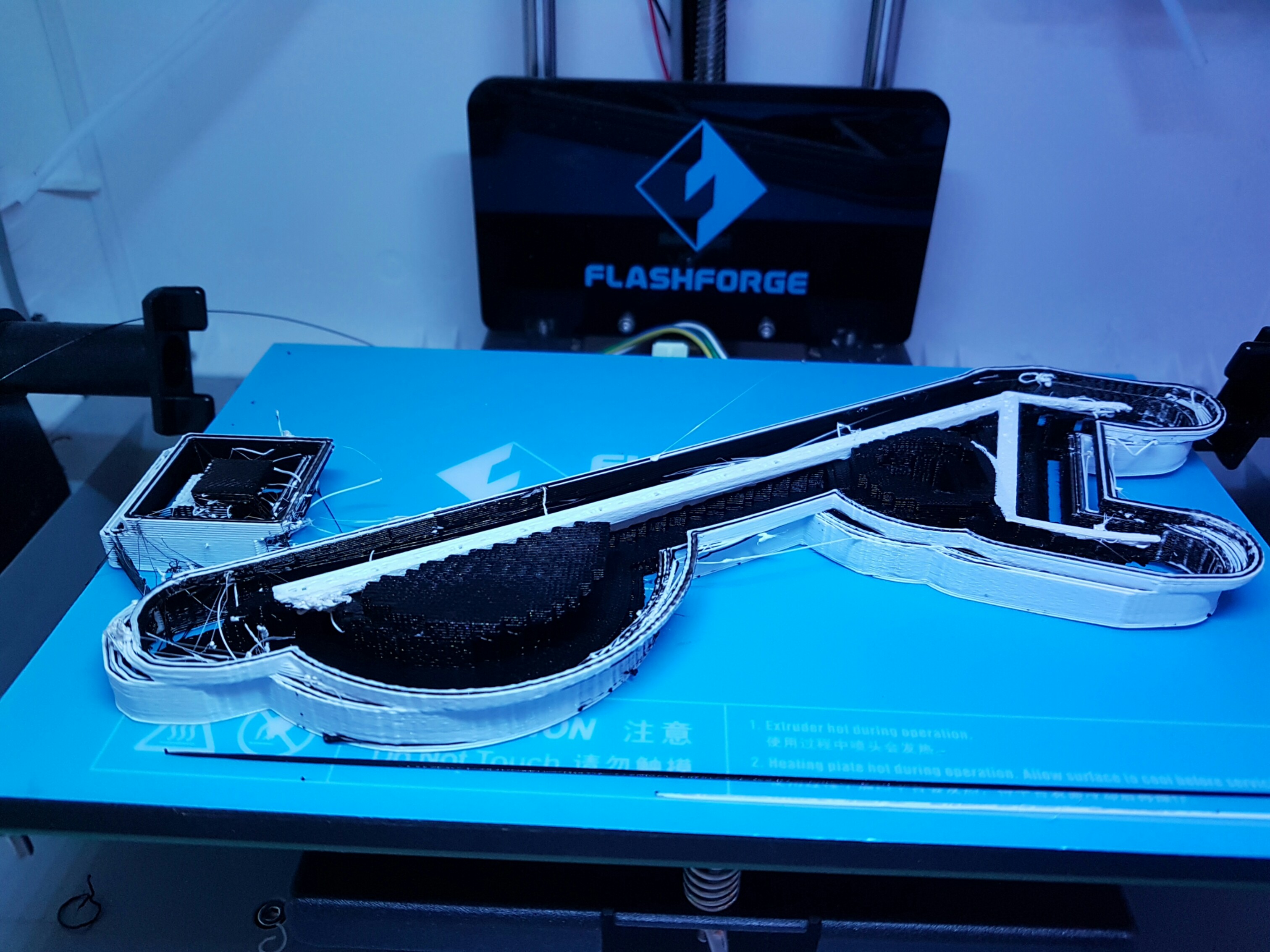

I noticed that sometimes when I print with simplify 3D the prints after a while get shifted to the side, this does not happen in the Flashforge dreamer original program.
Can anyone give a clue to why this is happening?

There is a mechanical problem in the x axis. Something is catching and causing the belt to skip or the motor to stall.
