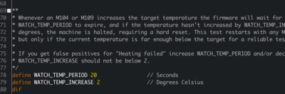

For printers using Marlin firmware (and similar that can be tweaked), implementing Math and a whole range of other tweaks is easily accomplished.
Copies of the firmware are posted many places on the net (or, you can edit the one on the printer - just save a backup).
For Mariin, it's an Arduino xxx.ino file that I open with the Arduino IDE. Of course, you need some knowledge about this stuff but, it's fairly easy to learn & do. Can have it respond to input from s3d command-line if attached to usb... as normally done if manually entering something such as M140...
I've tweaked mine - now includes Messages/Prompts in LCD and receives Button presses to do what I want.
I won't be doing a tutorial here but, will say that there are several files that are in the .ino but, only 'two' needed tweaking as the others (for what I needed to do) are simply the code relates/ties together variable name, some values, some this and some that.
A minimally-experienced programmer will know how to find/edit what's needed...
Summary - you can make it do almost anything and many printers use Marlin and similar.
Screenshots showing some example code... one shows Github location of file to download...
