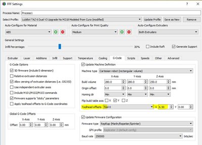

What I've got to work so far is to set the Toolhead offsets Tool0 to 6.50 and Tool1 to -6.50 under the G-Code tab. Then check "Apply toolhead offsets to G-Code coordinates" in same tab. I also comment out the M218 commands in the Startup Scripts in the Scripts tab (assuming you got the V3 Gcode commands from the link posted prior to this, or from Simply3D like I did).
Bottom line is if you're used to Cura, it knows the headsets from the machine settings. The previews in Cura seem to account for this and all looks great. When I started using Simply3D, I had the choice of sending the M218 gcode command at some point in my start up gcode that didn't make the machine wig out, or use the G-Code tab settings I described earlier. I opted to use the former and it worked. But I have check/uncheck the "Apply toolhead offsets to G-Code coordinates" to see the preview to preview the print, and remember to check it before I print. Matter of preference, you could try the M218 commands, just be careful because the firmware on the Lulzbot 6 may go nuts if not done at the right time. See my post on the Lulzbot forum https://forum.lulzbot.com/viewtopic.php ... =36&t=7273
