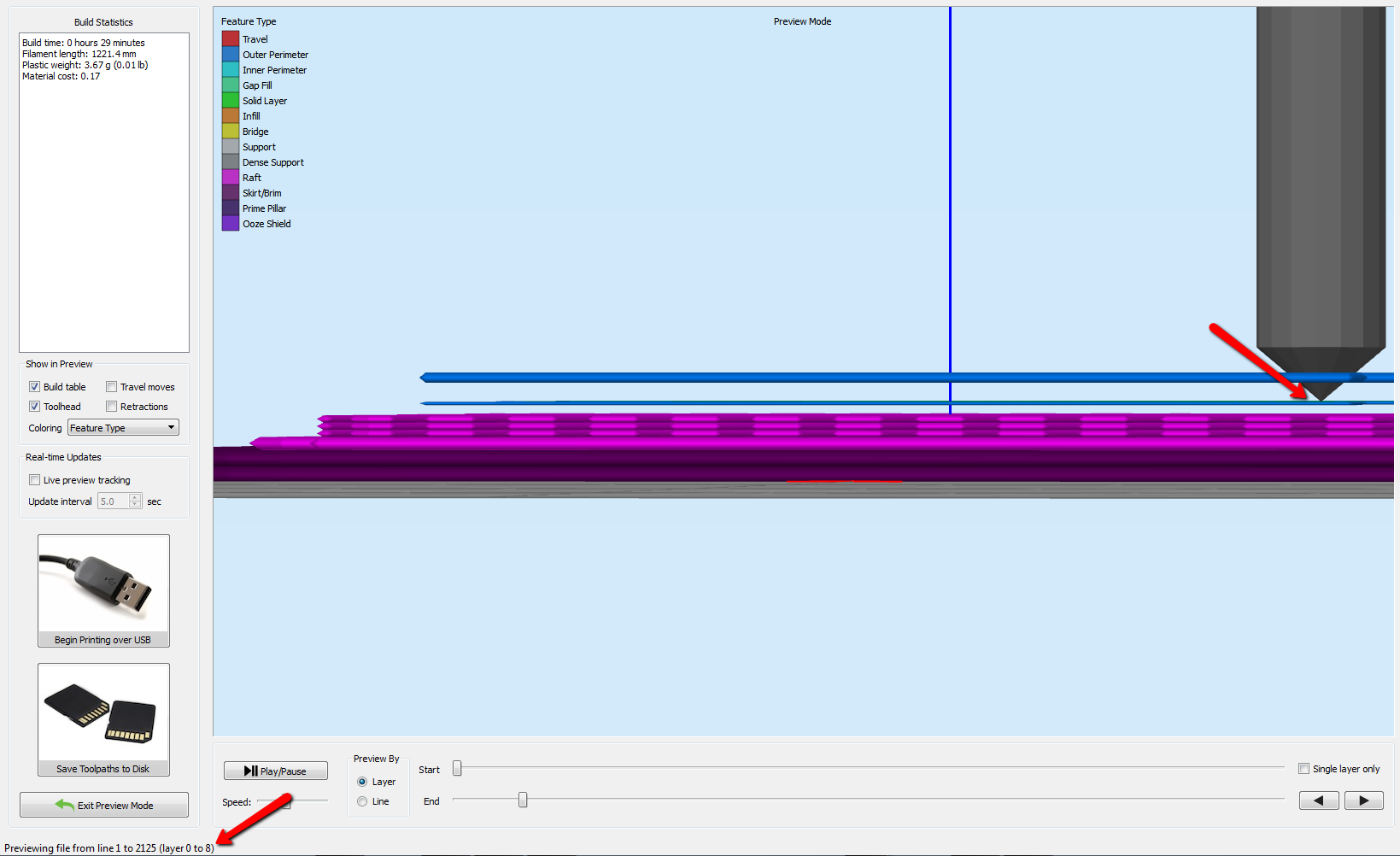

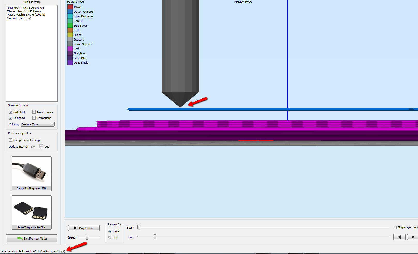

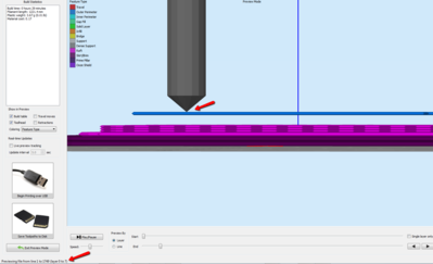

The first layer after the raft prints at the right height, but the next layers print at a lower height, then move up from there.
I'm including an example with a 1mm separation height (just for illustration purposes, so it's easier to see what's happening. I know that's not a reasonable height to actually use.) I'm actually trying to use somewhere between .22 and .35)
raft settings
raft settings
The last layer of the raft (layer 7)
The next layer, shown printing below the last layer of the raft (layer 8)
Layers 8 and up print from where layer 8 starts.

Looking at the preview, it looks like the 1st layer is printing correctly but then the subsequent layers are being pushed down with the hot extruder nozzle, making it stick to the raft.

I guess I'm not expressing my question properly. I know the separation layer is elevated. That's how it is supposed to work, and it is supposed to make the subsequent layers easy to separate, but it does not.
My concern is that the next layers seem to be printed LOWER than what is supposed to be to the bottom layer of the object. The result is that the hot nozzle pushes down the next layers (layers 8 and up in my illustration) and the next layers of extruded plastic into the raft, negating the effect of inserting the separation layer. At least that's what it looks like from the tool path illustration.
Are you saying that layer 8 (and following) are supposed to be printed lower than layer 7? Or that the illustrated tool path is not correct?
