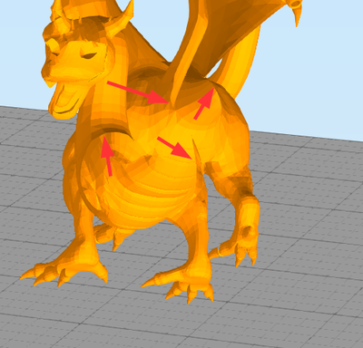

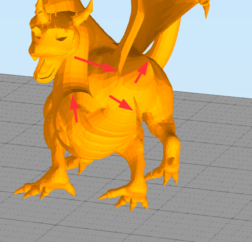

As far as I see the model is not designed as solid part but as a surface.
You can already see it in the preview:
