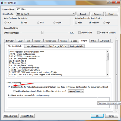

My FlashFroge Creator X (Dual) will not see .gcode on the SD card. Is there a way to get SD3 to "Save Toolpaths to DisK" as .x3g and not as .gcode?

Check the Process Settings under Scripts.
If you enable the Checkbox the x3g and gcode are placed in the same directory

Make sure you have the correct profile selected in the FFF process settings as well. Any printers that use the .x3g files should already have the checkbox MasterFX referred to pre-checked in their respective profiles.
