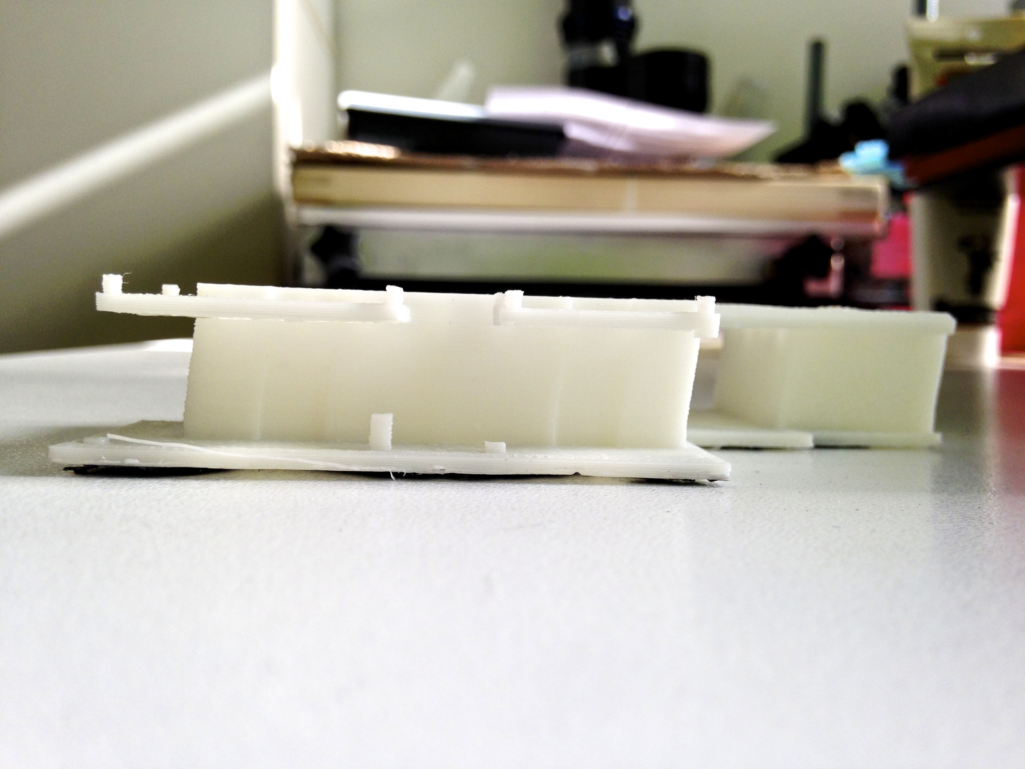

Anyway, i have a really weird problem. When i print some .stl models, the print come up bent! I mean, the up layer is not aligned with the previous layer over one side. I attach a photo for explain better (1:200 House model).
Bent house
As you can see, the layers are not aligned.

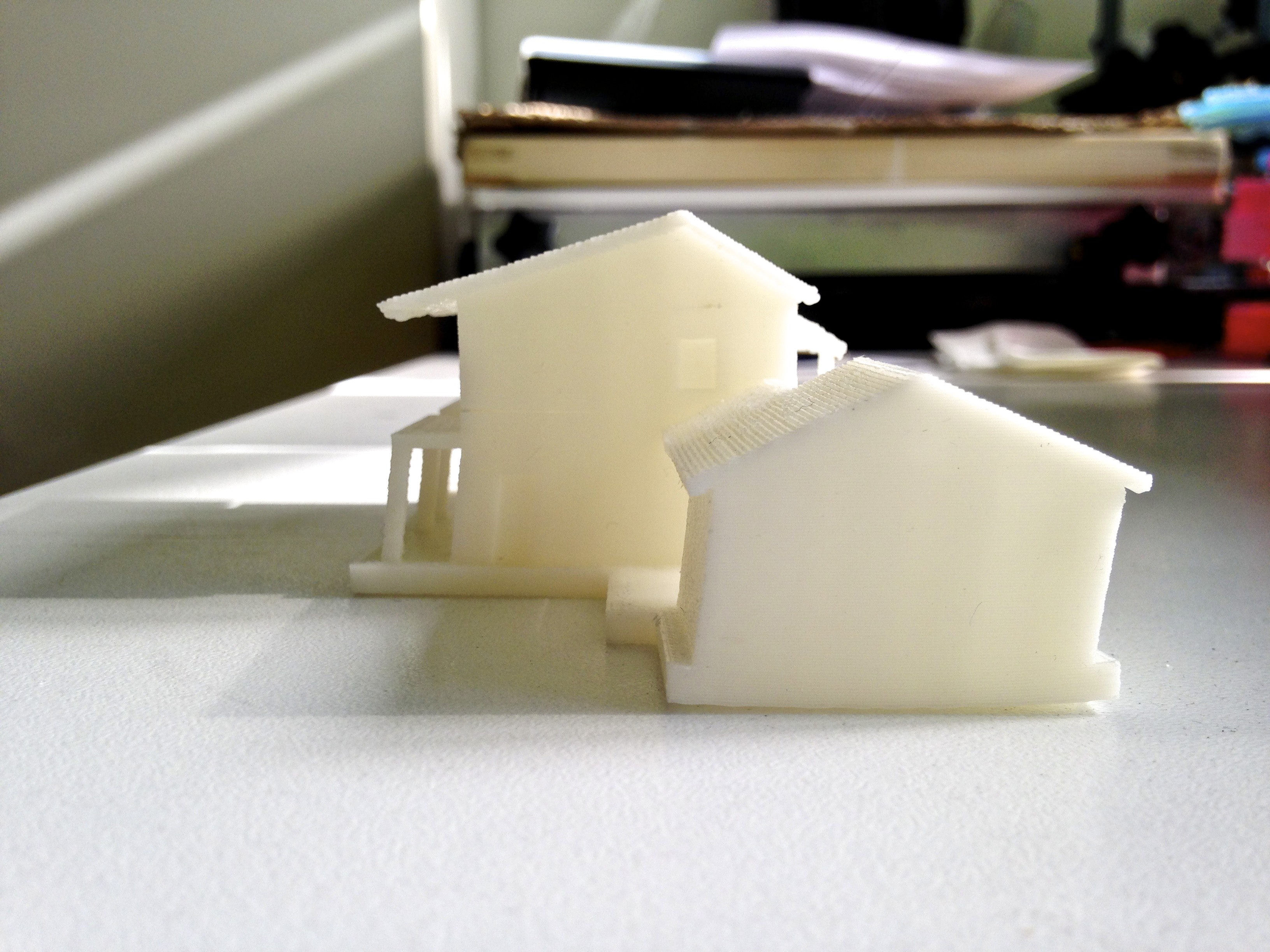

3) Tried to rotate 45° the model and send again to the printer. BIG SURPRISE! The house still bent, but now on the other side! No logical conclusion. (here a new photo! i'm not mad.)
Bent house - second try

Good news, bad news. First the good news, this problem has been discussed and apparently solved here, as quite few people had this happen. The bad? I don't remember the name of the thread it was in!

uncheck the "allow zeroing of extrusion distances" checkbox in the G-Code panel
