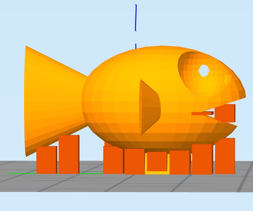

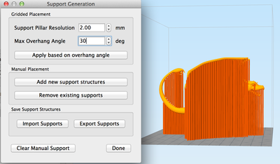

I've enclosed a screenshot of a fish laid out in S3D decorated with the supports that were automatically generated using the "Apply based on overhang angle" button of the Support Generation tool. As we can see, there are several flaws worth pointing out...
* The end of the tail is not going to print properly because of the lack of supports.
* The lateral fins aren't going to print properly because no supports were generated for them.
* The first layer of the anterior supports at the center of the base will be printed in mid-air.
* The end of the mouth may not print properly because of the lack of supports.
- Bob
