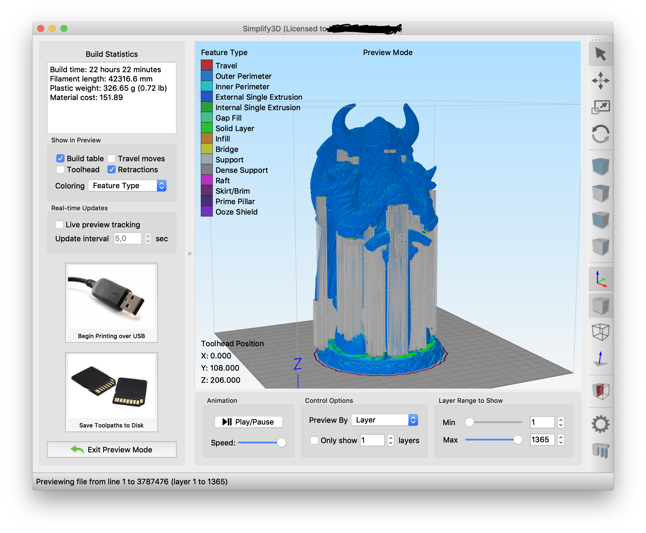

charliedrums wrote: Tue Nov 13, 2018 8:02 am Factory File
https://fddusacorp-my.sharepoint.com/:u ... Q?e=genPdf
Thank you for providing the file! I was able to recreate this issue and have documented my findings and sent them to the development team.
I was able to work around this in the meantime by selecting the option "Force Retraction Between Layers" which can be found in the Ooze Control Behavior section of the Advanced tab of the Process Settings.

Re: No retractions between printed support and perimeter?
I did not have 'Force Retraction Between Layers' turned on, I never had that turned on other than experimenting and it introduced other problems like unnecessary retractions and it often leaves a blob.
