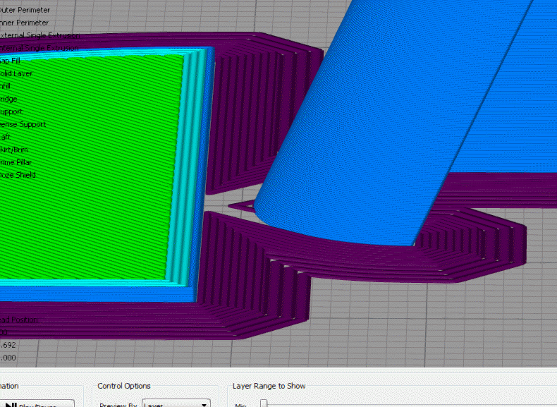

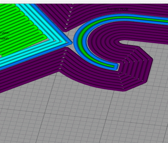

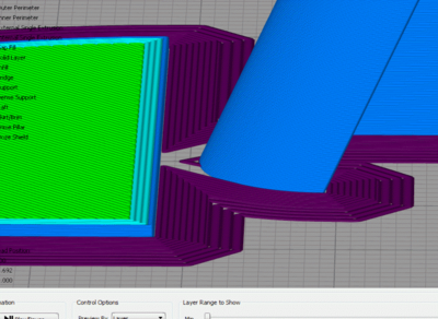

I add often a small object to critical corners and edges of a model to improuve the adhaesion to bed and avoid warping.

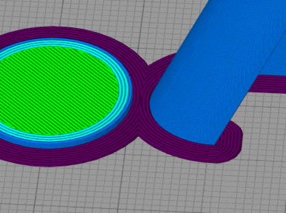

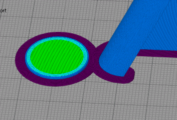

S3D 4.01 and further versions had no problem to cross over the brim lines so that the space between the 2 objects was closed.
S3D 4.1 exclude this space and let it open. Instead filling the gap it add a very small point without any sense.
How to solve this?

Version 4.10; distance between both objects is 2 mm, with 3 mm it is similar

Version 4.01; distance 3 mm
