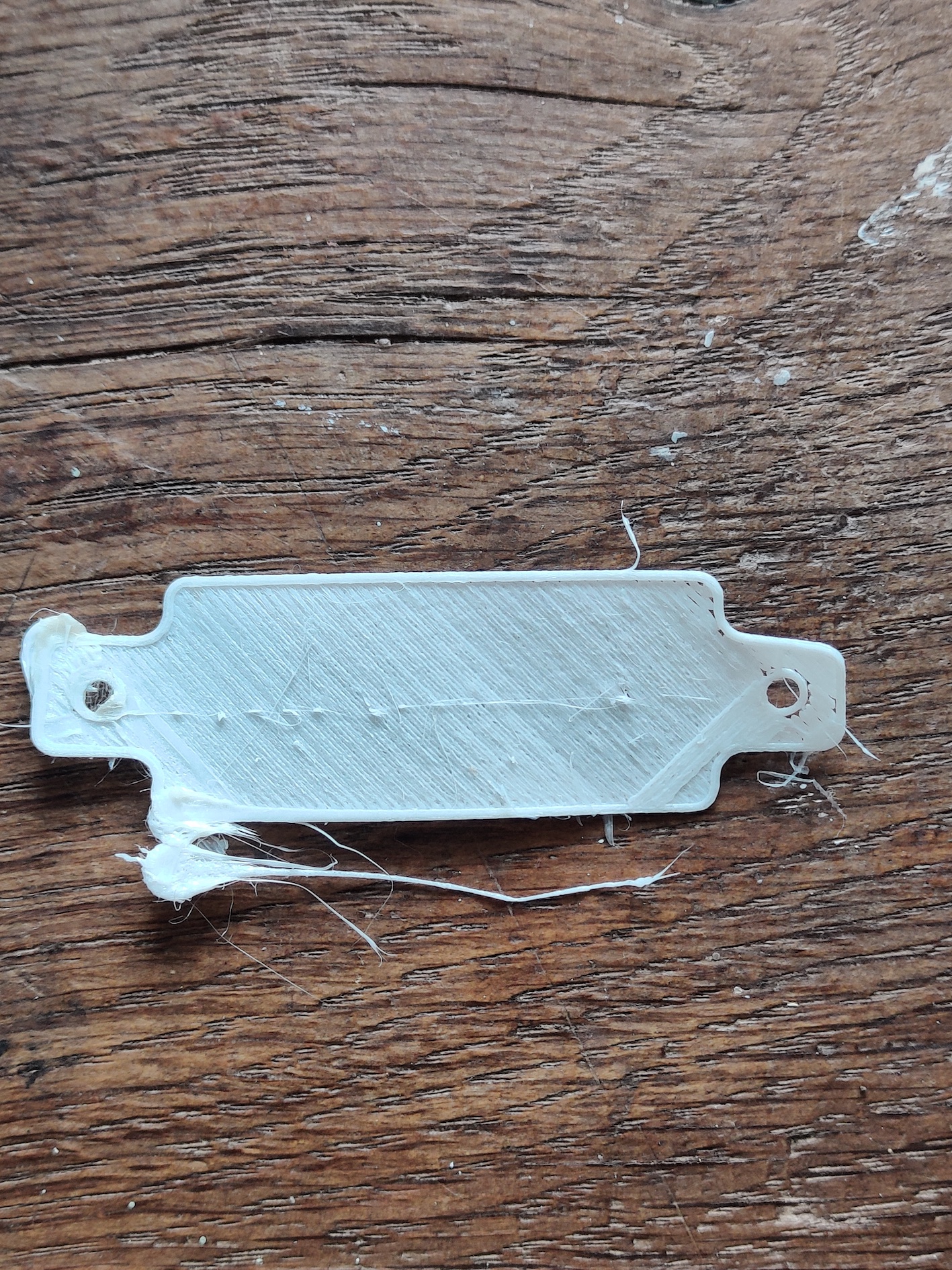

Using S3D 4.1.2
Not sure if this is connected, but I now have a problem where a splurge of filament is deposited at the start of each layer.
Is this also a bug in this version?
Thanks.

Here's a photo of a print I stopped after the first couple of layers. You can see the 'blobs' deposited when a new layer starts - the extruder gives a short forward burst.
I have tried printing files done some weeks ago and they are fine. It is only the new ones I produce that are showing this.
Any ideas?

Looking at the gcode file, here's an extract from the start of the file:
G92 E0.0000
G1 E-1.2000 F900
; feature skirt
; tool H0.300 W0.360
G1 Z0.800 F1000
G1 X81.420 Y95.820 F4800
G1 E5.0000 F900
G92 E0.0000
So does the G1 E5.0000 not mean 'extrude 5mm of filament'? In which case, what is going on? I don't see this line in older files.

Sorted.
The 'Extra Restart Distance' on the Extruder tab was set to 5.0. Have never even considered this parameter before, so no idea how that got changed.
All a bit odd......
