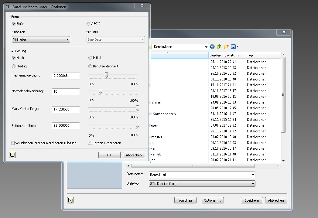

Re: Newbie Issues with Autodesk Inventor STL to print on Flashforge Creator Pro
Sat Dec 01, 2018 11:27 am
Strange...
I use your first method without problems.
Have you adjusted the export options ?
JNEWMAN
Joined: Thu Nov 29, 2018 8:38 pm
Sun Dec 02, 2018 10:59 am
No I did not use the export options, too complicated. I am merely getting up to speed with it, really helps having this community.
