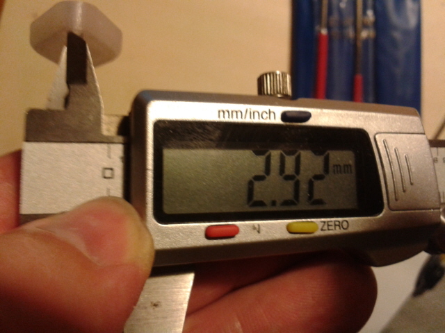

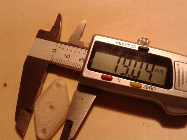

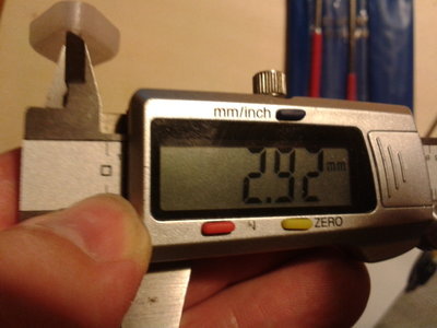

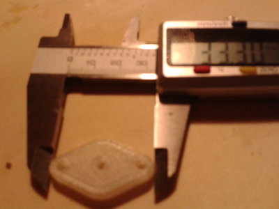

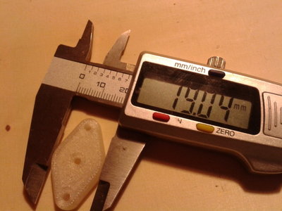

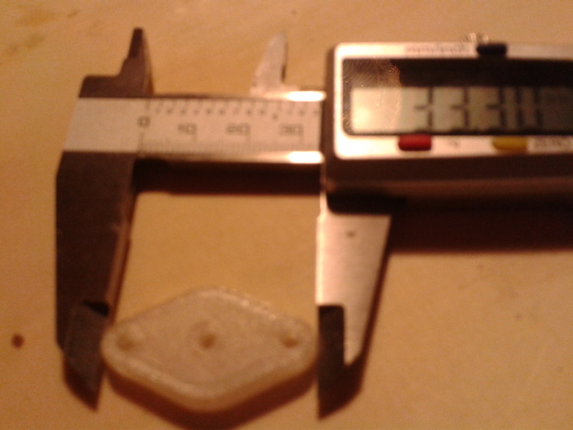

STL long way 33.50 mm print 33.30
STL short way 19.10 mm print 19.04
Screwholes please have a look to the pictures.
The messures fpr the hexagon-hole for the screw-head has 2 messures, strait on and diagonal
Material HDGlass, 240 °, nozzle 0.30 ExtrusionWidt 0.92, no retracts, no coast - have look to the factory-file
A print with ASA on the 0.60 mm nozzel will follow later, at the moment I try temp 225°, ExtrusionWidth 0.90
I can attache only 3 pic here??? More pic than below
