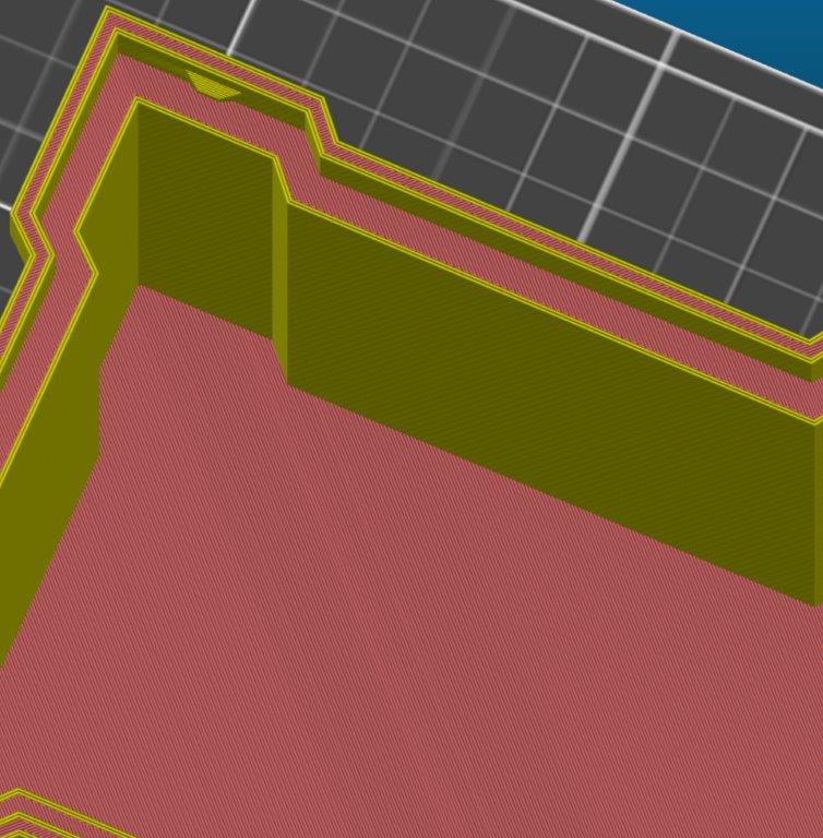

Using S3D I have a model bin printing with the following final surface pattern
However, when I use the Prusa Slicer I get
Is there a way in the S3D setting to achieve the same smooth pattern that Prusa generates?
Many thanks
Howard

Howard, In your FFF settings, change your "External Infil Pattern" to Rectilinear. Then change your "External Infill Angle Offsets to 45° and -45° :D

Many thanks. That works a treat.
