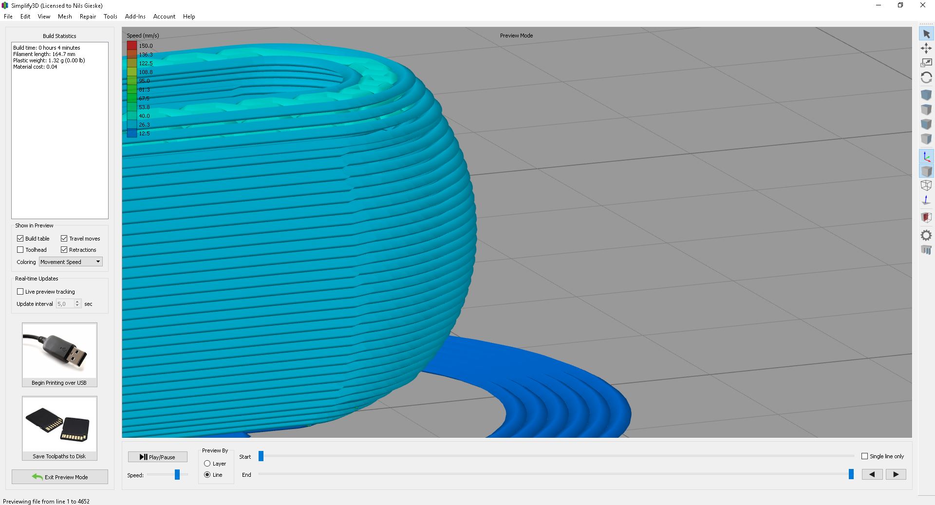

Hello,
during vase mode at the start of the radius (tangential transition) slicer produces these small z axis jumps on multiple layers, that makes the print uggly.
it turns out to be a real bump where it should be smooth. the part is symmetrical and the oppisite side is absolutely clean.
any ideas?
Ingo

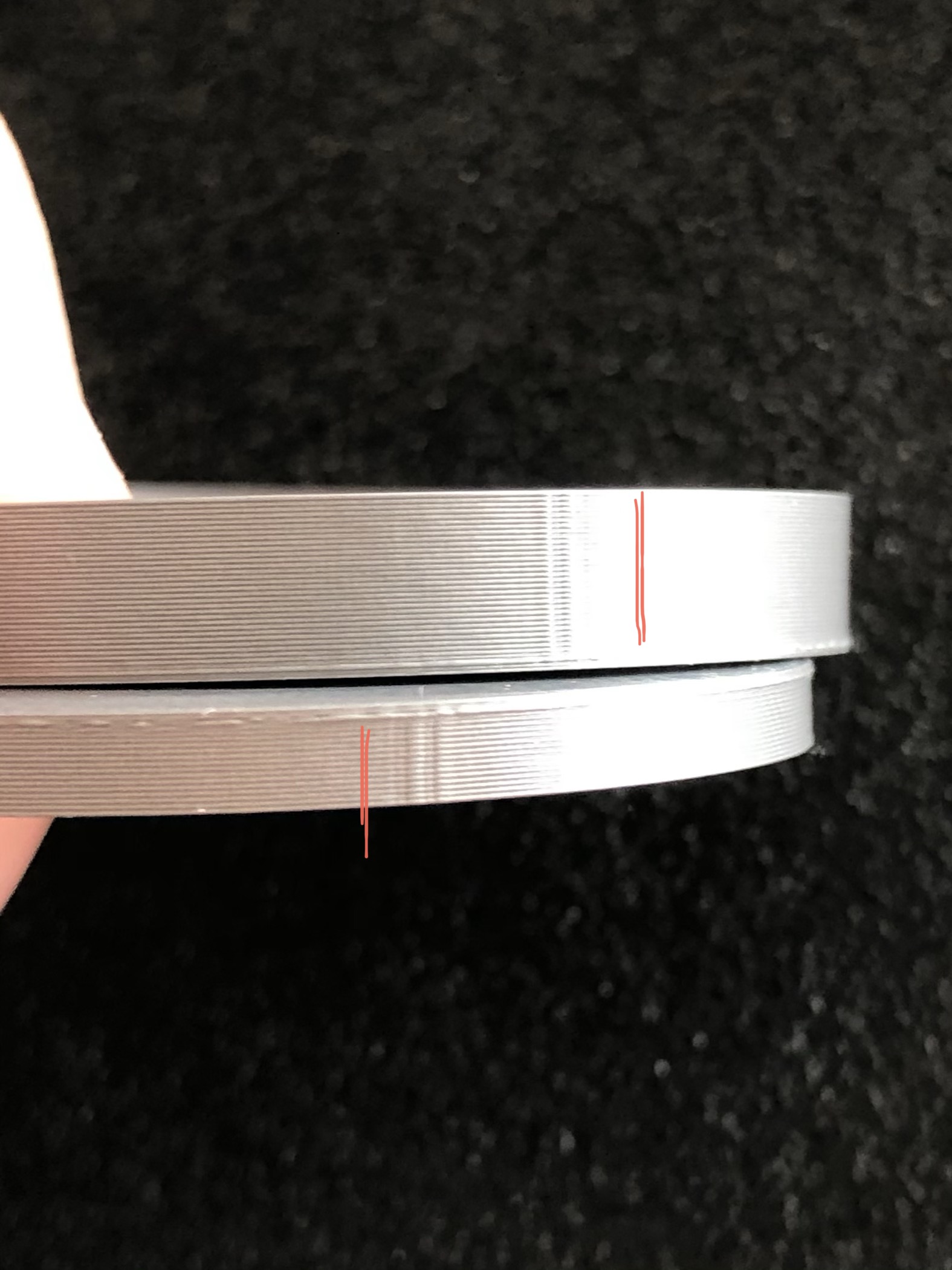

Have the same problem on a round cylinder in vase mode.
I've done a lot of testing to find the problem.
It's a drawing from Fusion 360 floor only and a 0.4 mm wall.
Different people have tried other vase models and have the same problems.
We tried it on different systems, printers and slicers, these lines only show up in Simplify code files.
The preview in simplify show the lines
Does anyone have any idea where the problems are coming from?
The two vertical lines are not at the draw from fusion 360
