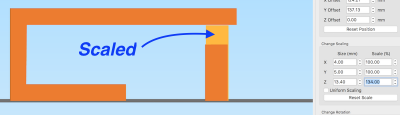

As previously mentioned, you can add a Support Part...
Example shows placement of two Support Parts:
• one rotated 180º about it’s Z-axis
• both were placed under overhang and use the Scaling feature (showing one scaled Z, non-uniform)
Attached is the Support Part. You can scale that too as needed (current dimensions may be heavier-duty than you want...)
For the example, I added some supports manually...
Support1.stl
(1.45 KiB) Downloaded 129 times
